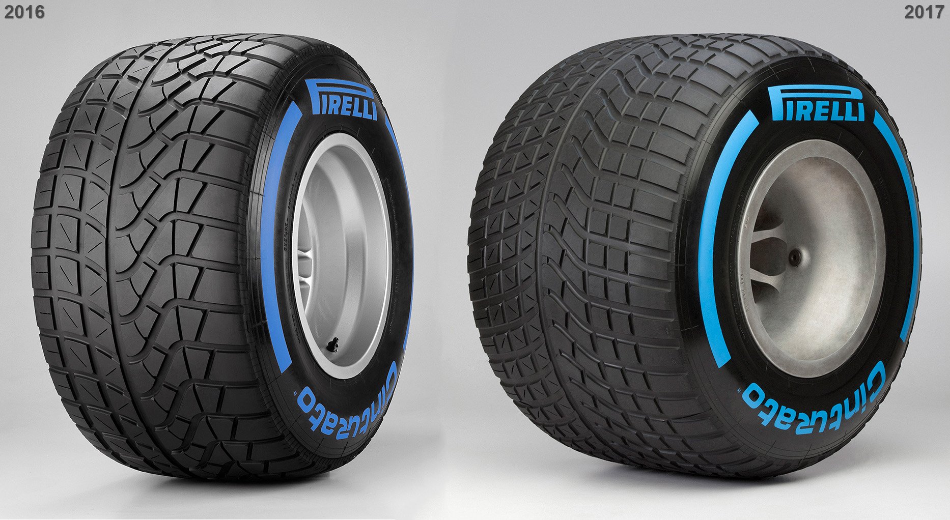

I think one problem would be that the water is effectively deflected outwards of the tyre (inside and outside), so any deflectors would need to be positioned on the sides on the tyres, not directly behind. This obviously poses problems for the outboard deflectors, which would then increase the width of the car. For me, this is a dealbreaker for deflectors.
From the video posted earlier.
The current tread pattern angle is quite extreme.
So, for example, this would have negligible effect.
