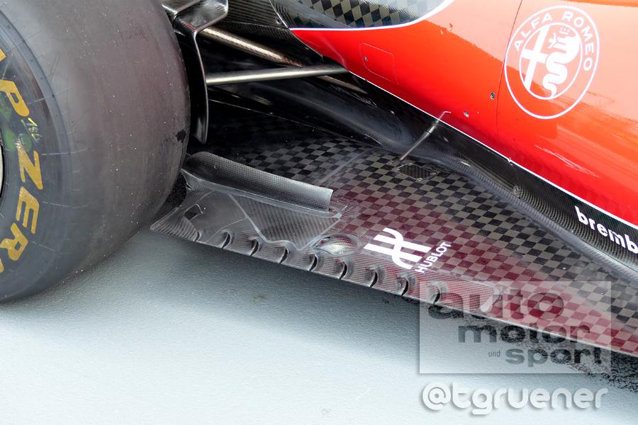

jagunx51 wrote:https://pbs.twimg.com/media/CPQHhG0UEAAiVK4.jpg:large
wot dhe vaak ...??! =D>
Could thuis be onze of the big gains we see from Ferrari this weekend? A simple but effective way to seal the sides turning the whole backend of the car more and more into a big diffuser?

Jolle wrote:Could thuis be onze of the big gains we see from Ferrari this weekend? A simple but effective way to seal the sides turning the whole backend of the car more and more into a big diffuser?
Underbody flow tends to stagnate in that area, which raises local pressure and also creates a bottleneck that raises pressure upstream. The net effect is less downforce and higher drag.
Those slots should improve underbody efficiency by energizing the stagnant flow. (Or so goes my logic.)

bhall II wrote: Underbody flow tends to stagnate in that area, which raises local pressure and also creates a bottleneck that raises pressure upstream. The net effect is less downforce and higher drag.
I'm not quite sure how you would energize stagnant flow below the floor by squeezing even more air into that area in front of the tyre? Probably you're right and that is surely what they want to achieve, I just struggle to grasp how it should work. :?:

henra wrote:I'm not quite sure how you would energize stagnant flow below the floor by squeezing even more air into that area in front of the tyre? Probably you're right and that is surely what they want to achieve, I just struggle to grasp how it should work. :?:
It's just my best guess, and I could be wrong. A look at flow velocity might make it easier to see...
I suspect the idea is to manage the flow's pathlines to minimize the bottleneck.

Stagnation in front of the rear wheel over the floor is used to create the same effect as a front splitter, so it isn't bad in itself. What might cause issue is if there is no way this air can then escape which can cause blockage of airflow around the coke bottle.
