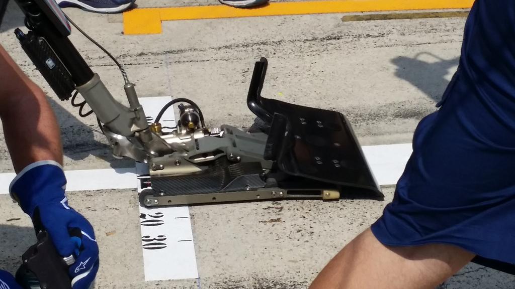

Craig Scarborough ‏@ScarbsF1
Front jack lifts the car then a levers pulled to allow the handle to swivel sideways so the jackman is out of the way
The second hand lever operates the pneumatic catch to drop the car #PitStopTech

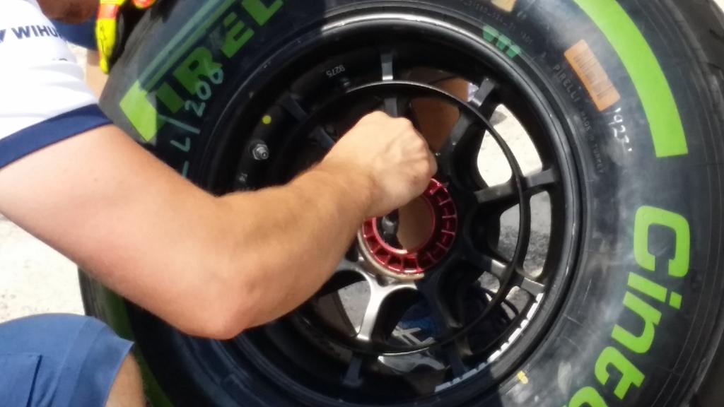

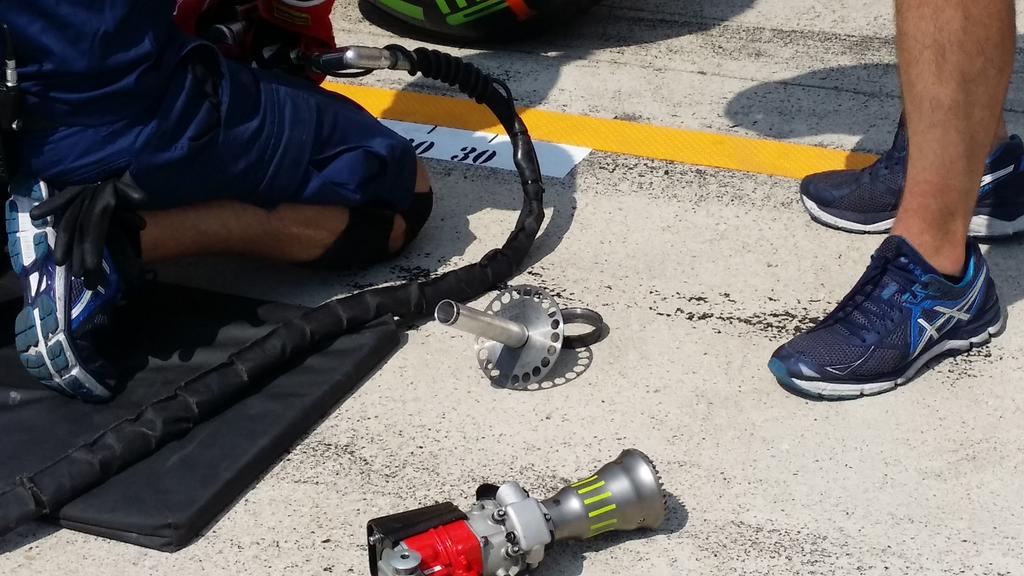

Nut is retained in the wheel by this threaded collar, the tool is used to release the collar if it jams on

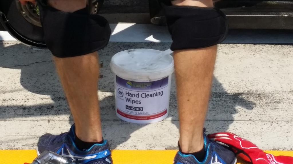

Any jams mean the axle threads are clean with wet wipes! #PitStopTech

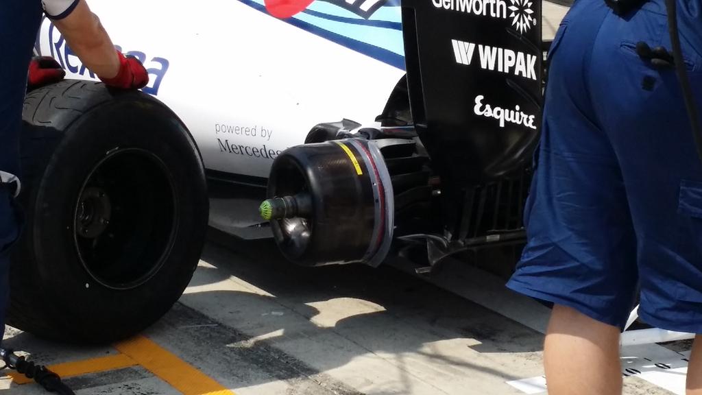

Then both threads are regreased #PitStopTech

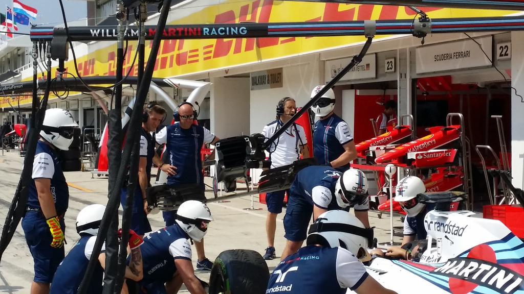

Nose changes are practised, the crew all wear @ruroc_army ski helmets #PitStopTech
