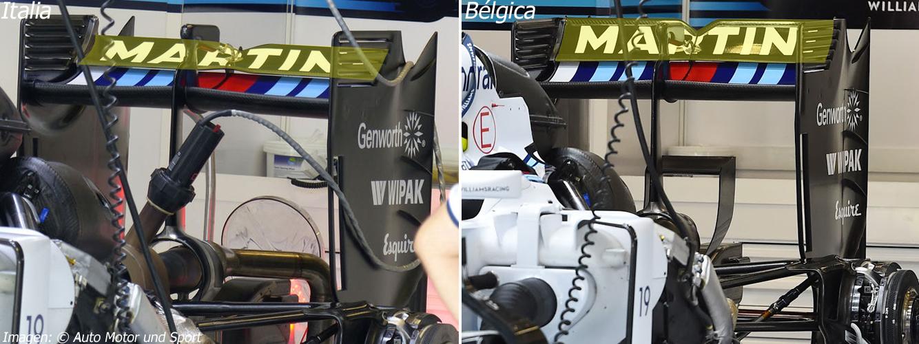

Craig Scarborough ‏@ScarbsF1
Williams newer spec FW flattened so much there's a gap by the adjuster!

Re: Williams FW37 Mercedes
Interesting way to reduce drag on the wing there. Rather than run a much shallower wing, they just lopped the top off it and reduced the height.
