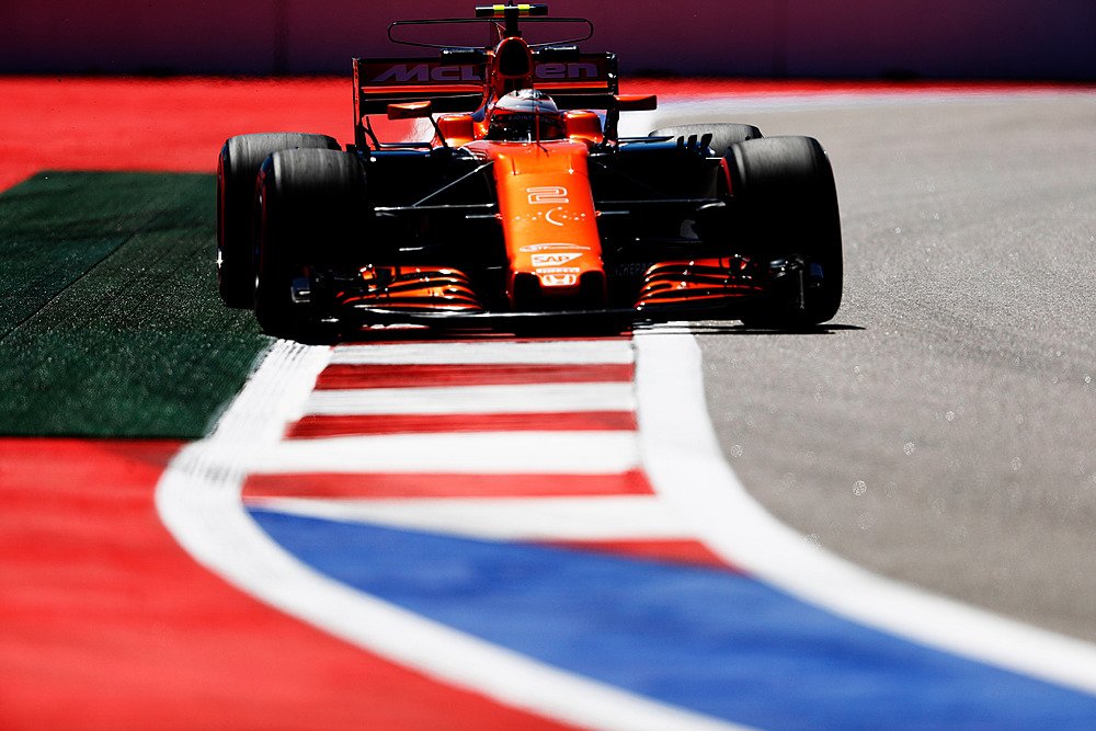

Looking at that Picture of the new RW Endplates got me thinking if that's McLarens version of a bendy RW. The only thing connecting the upper with the lower Part of the Endplates is a pretty narrow piece of CF whereas others have the whole lenght of the Endplates to take the Load. And that Piece is conviniently on the foremost position of the Endplate which would allow the RW to get shallower the faster the Car goes. :twisted:
How would the center pillar fit in this story? Bend as well? Or am I misunderstanding what you are saying?
Re: McLaren MCL32 Honda
Yes, a little flexibility shouldn't be to hard to achieve. Basically i'm thinking that the Top part of the RW folds backwards and the small connection between lower and upper Part of the RW Endplate acts as a hinge, thus reducing drag.
Edit: Incoming Paint skills of Doom.
Edit 2: Looking at it again, the RW Pylon could sit straigt in line with the "hinge" part of the Endplates, making it even easier to work. :twisted:
(god i hope this doesn't make me look too stupid :mrgreen: )

I doubt it, as the end plates aren't a structural part of the wing, that's all the central pillar

dont know if sun+shadows+angle is playing tricks, but looks like rw main plane has been reduced in height to avoid drag, they have done that before
EDIT
seems only on vandoornes car
He might have a point though. If they aren't structural part we could theoretically think of it as taking them away (all forces are on the pillar). That would allow the wing to bend. So making that part less rigid would allow for some bending at least near the edge.Without the pillar bending I don't think it would be much however.

f1rules wrote:
28 Apr 2017, 11:24
EDIT
https://pbs.twimg.com/media/C-fS6oLXkAI5YIx.jpg:large
It could be....car looks difficult to drive balance wise, for the first time this year.

wesley123 wrote:
28 Apr 2017, 11:22
It may be on this, but it isn't on most cars, and hasn't been for a long time.

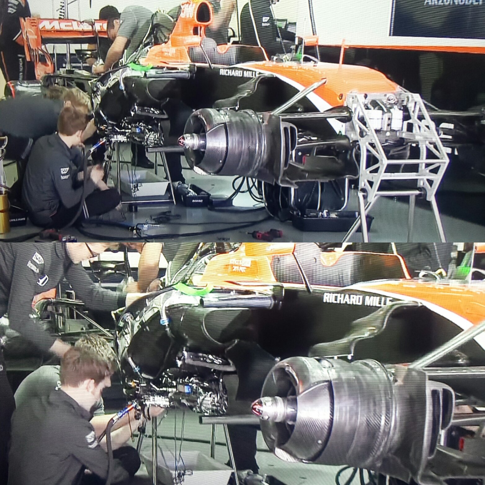

So the second Inlet is indeed for driver cooling: https://twitter.com/ScarbsTech/status/8 ... 2782903296
