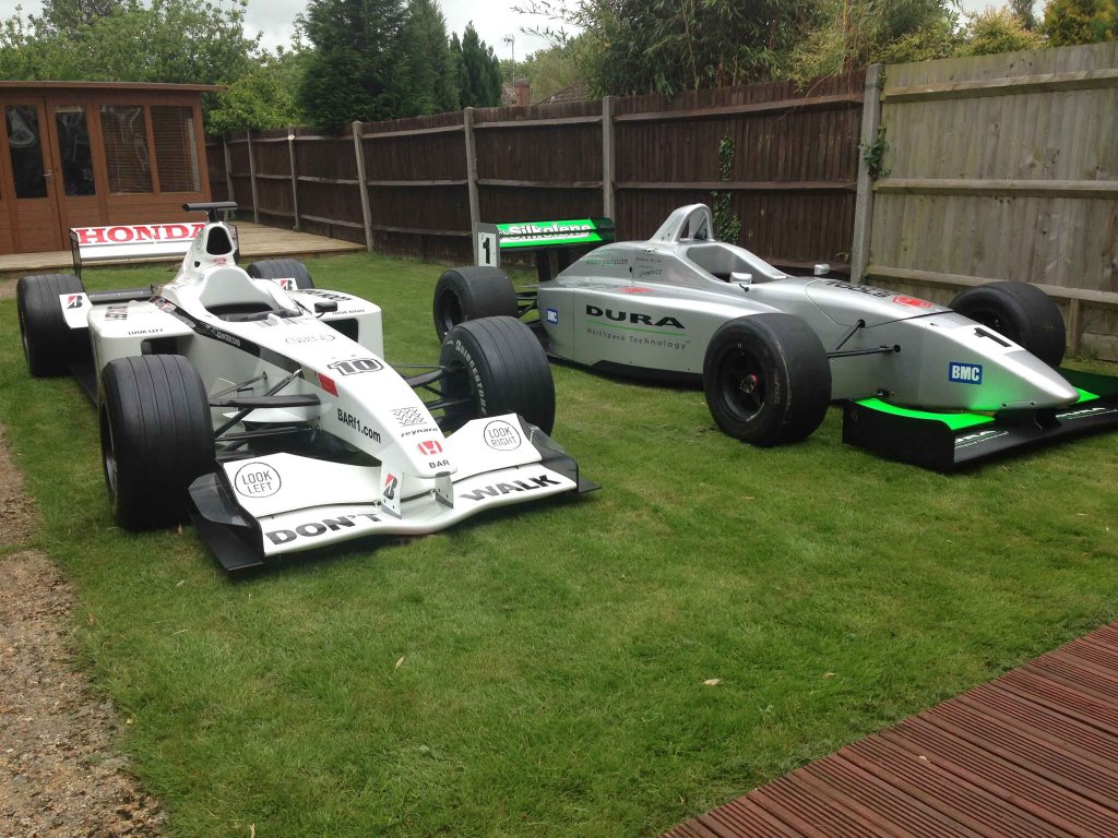

Nice project, especially like your backyard.
