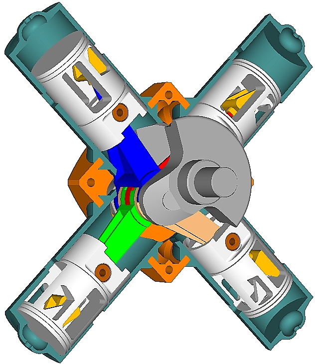

Compare to the PatAt Cross Radial 2-stroke Diesel with the Junkers JUMO 2-stroke Opposed Piston engines.
The first has a short crankshaft with a single crankpin driving four pistons.
In the Junkers JUMO 223, there are four crankshafts, each having 6 crankpins (i.e. 24 crankpins in total, i.e. one crankpin per two pistons), there are also several heavy gearwheels.
One of the built-in characteristics of the PatAT Cross Radial is that it achieves as asymmetric transfer as desirable.

Regarding the “much more complex design” of the PatAT or PatATi 2-stroke engine, I count only three moving parts in total: a crankshaft, a connecting rod and a piston (i.e. as in the simplest 2-stroke conventional engines):
(stereoscopic animation; instructions on how to “look” at it, at http://www.pattakon.com/pattakonStereoscopy.htm )
The three moving parts are modified to offer both: asymmetric transfer and asymmetric intake.
Is it a “much more complex design”?
A decent modern 2-stroke needs an additional mechanism to control the intake (like a reed valve, or like a rotary valve) and compromises with an inevitably symmetric transfer (the exhaust port stays open substantially after the end of the transfer).
In comparison, the PatATi, without using reed valves or rotary valves or anything else than its crankshaft - connecting rod – piston - casing, achieves a highly asymmetric and efficient intake, and a highly asymmetric transfer (if desired, the transfer ends after the end of the exhaust).
The PatATi is simpler (because, among others, the PatATi uses fewer parts) and better (because, among others, the PatATi offers new options / capabilities not possible before).

and in the OPRE engine (here they are shown the parts of the OPRE prototype engine; spot on the piston structure and on the location of the wrist pin):
Quote from http://www.pattakon.com/pattakonOPRE.htm :
“The transfer of the wrist pin - i.e. of the thrust loads - away from the hot combustion chamber and away from the ports, solves another problem of the opposed piston engines: it allows "four stroke" like lubrication and oil consumption.
OPRE's piston skirt can avoid the touch with the hot cylinder wall because the thrust loads are taken at the other side of the piston, onto the cool, rid of slots and well lubricated cylinder wall of the scavenging pump.
In comparison, the piston skirt of the conventional opposed piston engine thrusts heavily onto the hot, especially at exhaust side, cylinder wall, around the port area where the openings restrict the contact surface, requiring plenty of lubricant and inevitably resulting in lubricant consumption.”
End of Quote
Thanks
Manolis Pattakos
