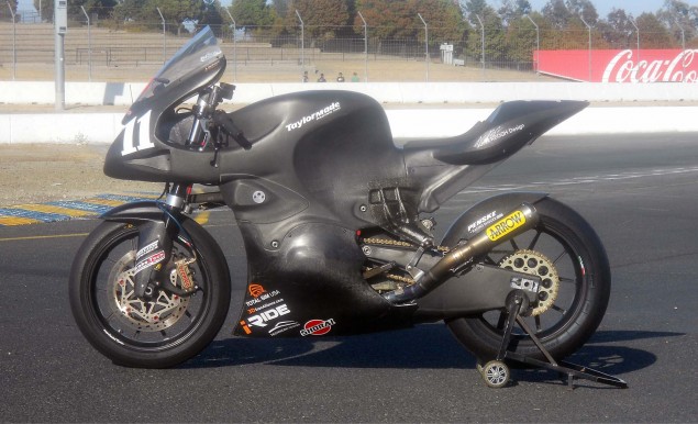

Brough Superior unveiled a new race bike. Debuting at the Petersen Museum reveled its intentions to race in the Moto2 Championship.
Constructed for Brough Superior in the Los Angeles . British design but built in the U.S by workshops of TaylorMade Racing. The new bike has been jointly developed for Brough by Taylor and UK-based designer John Keogh, who worked with Buell on creating the Firebolt and other models.
Name, mark: Taylormade Carbon2 Btw. who is Taylormade Racing? Taylormade racing based in Van Nuys, Los Angeles, California, USA, is a specialist in innovative design and manufacture of carbon-fibre components, to Formula One standards. It is a discreet supplier to the Yamaha, Honda and Buell race teams as well as producing its own range of hi-tech exhaust mufflers for street bikes, which have attracted much attention for their light weight and integrated design.
Tech goods:
:D

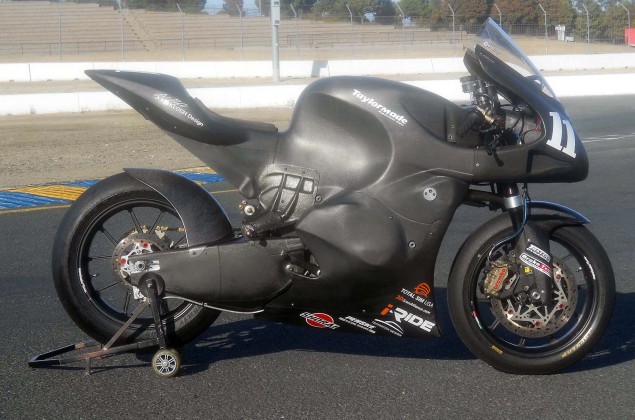

  1. -Obvious Moto2 spec engine: Honda CBR 600, 4 cyl
  1. -unique carbon fiber composite chassis that integrates the fuel tank and bodywork in a single monocoque fabrication – "fuel inside chassis" => thus cutting weight while increasing overall stiffness.
  1. -rear carbon fiber swingarm + Penske shocks
  1. -high front 43mm in diameter fork tubes=>more space => less obstructions for cooling air
  1. -CofG placed vertical narrow fuel tank (almost behind engine) => lover "splashing" and fuel drop efects=> better race pace

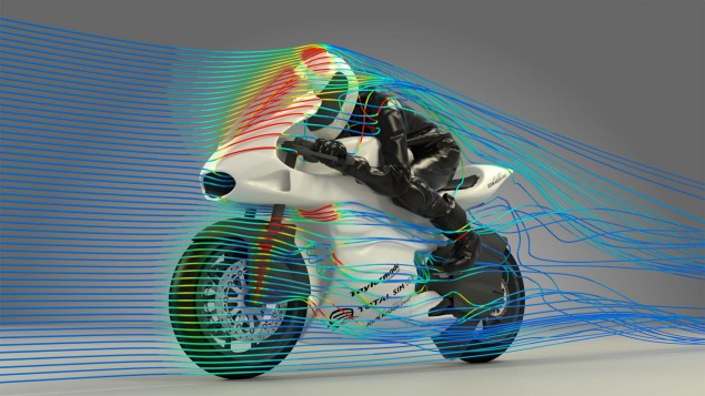

  1. -rear tail-sectioned radiators look picture below (KLIK for enlarge pictures :wink: )
Nice CFD pic, Nice view into low pressure zones behind exit of the rads and also steady flow around sides of windshields...

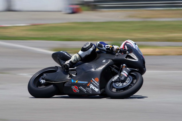

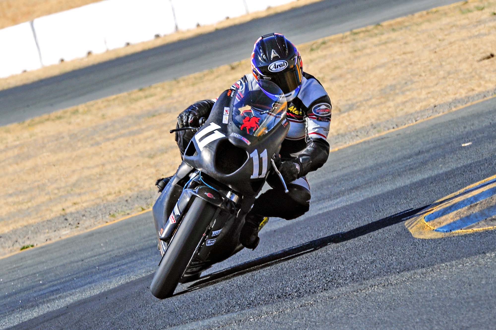

Test rider Former AMA racer and factory Buell racer Shawn Higbee has been developing the bike on track, and says:
It's very narrow, so that's one advantage,” “And also very light and agile. But the thing that stands out most is the
way it absorbs bumps even when you're trail-braking very late and very hard into a turn, because the front end has such little stiction when the bike is leaned over. With a conventional telescopic fork, when you get a full lean and the forks get twisted and bound with lateral forces, they don't work as good as they normally should – but on this bike the front keeps right on working well. It gives you an awful lot of confidence to attack the corners at full lean even with the brakes hard on. It has so much potential once you get your head around the different things it'll do that a conventional bike will not.

I can't avoid thinking that the radiator position will create some downforce. I remember reading that Honda played with downforce on bikes some years ago only to conclude it was not worth it.
I can see how in the corners it would push you out (but also push the tire on the tarmac, does that balance out?). Traction is limited on acceleration while the bike is still leaning, so the same there, but downforce should really help under braking, which is largely done while vertical, which is also when the speed is highest (at least at the beginning).
Does anybody know why downforce doesn't help in motorbikes? Increase in general drag? Just cornering effects? Tire life? Changing bike behavior? Too much exposed body?
