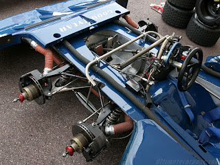

As a follow-up on another thread, which suspensions were the most intriguing and/or different ever?
Ferrari 312 B2;
Sombrero
