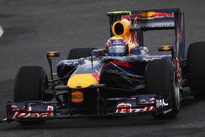

forty-two wrote:Some drawings in the "Reducing the drag of a two element wing through stall" thread suggested that a fluidic switch can work like this, or with careful tweaking could be made to work without a secondary signal.
Perhaps RB decided it not too much of a loss to have two lots of ductwork instead of develop a single signal fluidic switch?
forty two,
Just thought I would point out something pointing to your post of sliding the splitter in and out. In this picture is something very strange (having built a few splitters myself)... two square tubings that apparently have the splitter mounts slide into them, as they proceed the location of the splitter. If this is the mounting of the splitter with matching smaller diameter tubes inserted that were hinged and slid inside for static tests and back out for running, it would follow your theory... :idea:
forty two,
While I don't disagree with you on the idea, I think that this picture is a little misleading. The holes you see in this image are, I believe actually the front edge of the splitter, not the mounting holes for the splitter. Some other pictures from this incident show that the splitter remained attached throughout.

While on the grid, RB have always been keen to position a gang of employees to conceal the rear of the car.
Personally, I suspect that this could very well be theatre, in order to draw the prying eyes of photographers to the back of the car, while the interesting gubbins is actually elsewhere (the splitter, FW etc).
We've seen lots of pictures of the RB's rear end, and as far as I can work out, nobody has spotted anything groundbreaking there apart from details about the EBD, but the secret about that has been out now for some time (or at least so we all think), so why keep "hiding" it?
The way I see it, they're either:
- Hiding something really sneakily clever in this area
- Hiding nothing at all, but trying to draw glare away from somewhere else on the car
- Hiding nothing at all, just trying to get a dumbass like me to waste my time asking this question, generating "column inches" for their PR machine.
What does anyone else think?
