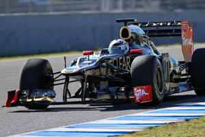

0501 Test.Strange things on left suspension.
kwanchepan
Joined: 27 Jun 2010
Post Tue May 01, 2012 11:49 am
Variable geometry control arms? Integrated springs? Whatever they are, my interest is piqued.
bhallg2k
Joined: 28 Feb 2006
Post Tue May 01, 2012 12:15 pm
Strain gauges would be my guess
bot6
Joined: 2 Mar 2011
Post Tue May 01, 2012 1:11 pm
bot6 wrote:Strain gauges would be my guess
+1
