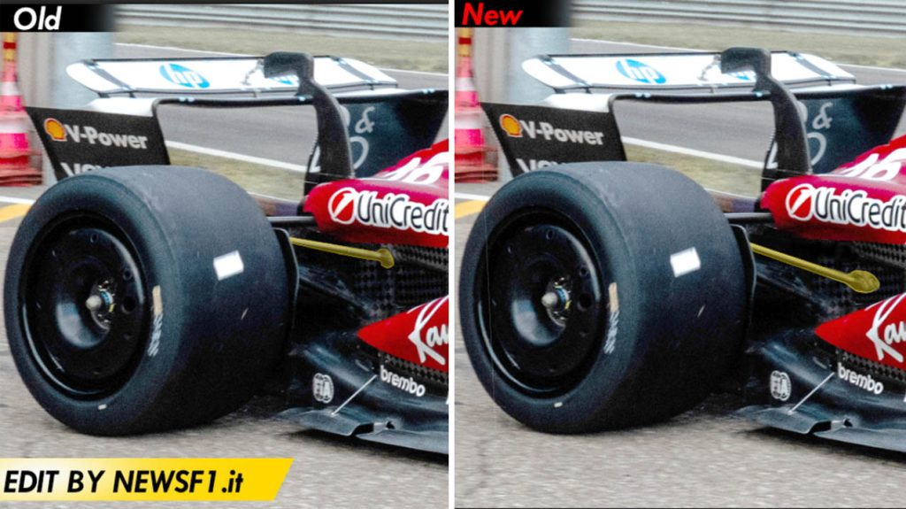

Does anybody with a keen eye spot anything different?
It looks identical to me. But then again, I guess any changes were likely fundamental, but minimal visually.

Not great pictures for spotting changes, but I don’t think it will look that much different externally.

Some thoughts depicted from the Italian media:
"The new upper leg was mounted forward and downwards in order to increase the anti-squat and also to modify the car`s roll center more to the inner car chassis. The issue was that the car had a bigger roll movement in the high-speed corners, meaning the ride height wasn`t neutral, thus generating inconsistent DF levels from the floor. The roll center is in conjunction with the CoG, and the question is why they didn`t design a suspension with a bigger anti-dive and anti-squat effect. The answer is that adopting this design would lower the car`s CoG. But the SF25 car has a lower CoG (due to all the radiating masses being lower) than the SF24, and they want to avoid the issues VER had in 2023 and Macca last year with the front tyres warm up in qualy and the driver's sensitivity to the car. Thus, adopting a conservative anti-dive and anti-squat design was affecting the car`s roll in the high-speed corners, knowing that CoG is closely related to the car`s roll center ...
In addition, in order to cure the roll issue, the lower rear leg was moved slightly forward, and the carbon shrouds around the suspension arms were reprofiled for a better airflow towards the diffuser. Another issue with the car rolling was that lowering it too much on one side, the vortex generated wasn`t powerful enough in order to seal the floor against the exterior air infiltration under it ...
This car design error was due to the lack of knowledge and know-how of an entirely new project around the adaptation of the new pull-road front suspension, something that wasn`t the case for the Red Bull and particularly for the Macca team ...

Ferrari brought a subtle yet intriguing change to the SF-25 during their Mugello filming day: a tweak to the rear suspension geometry that could have big implications for aero balance and ride stability. The update seems to mirror something Mercedes introduced earlier this season. If you're into the details of anti-lift, anti-squat, and suspension-floor interaction, here's a full breakdown worth checking out:
