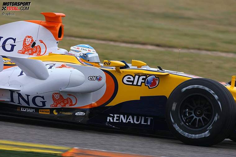

Did anyone notice the unusual shape of the mirrors? Quite LOoong... Looks like they 'work' together with the 'ears' right in front of them.

Re: Renault R28
I guess this car has even more secrets.
Look at those two holes. I think they've made some quickly adjustable suspension system that can enable quick changes of suspension stiffness or ride height even during pitstops - just like it is done with front wing angle. Not to mention how valuable it can be between qualifying sessions.

Re: Renault R28
manchild wrote:I guess this car has even more secrets.
http://www.f1fotos.be/wintertests2008/v ... 20(44).jpg
These are pre load adjusters for the torsion spring. Most teams have them, although they are covered up with stickers.
