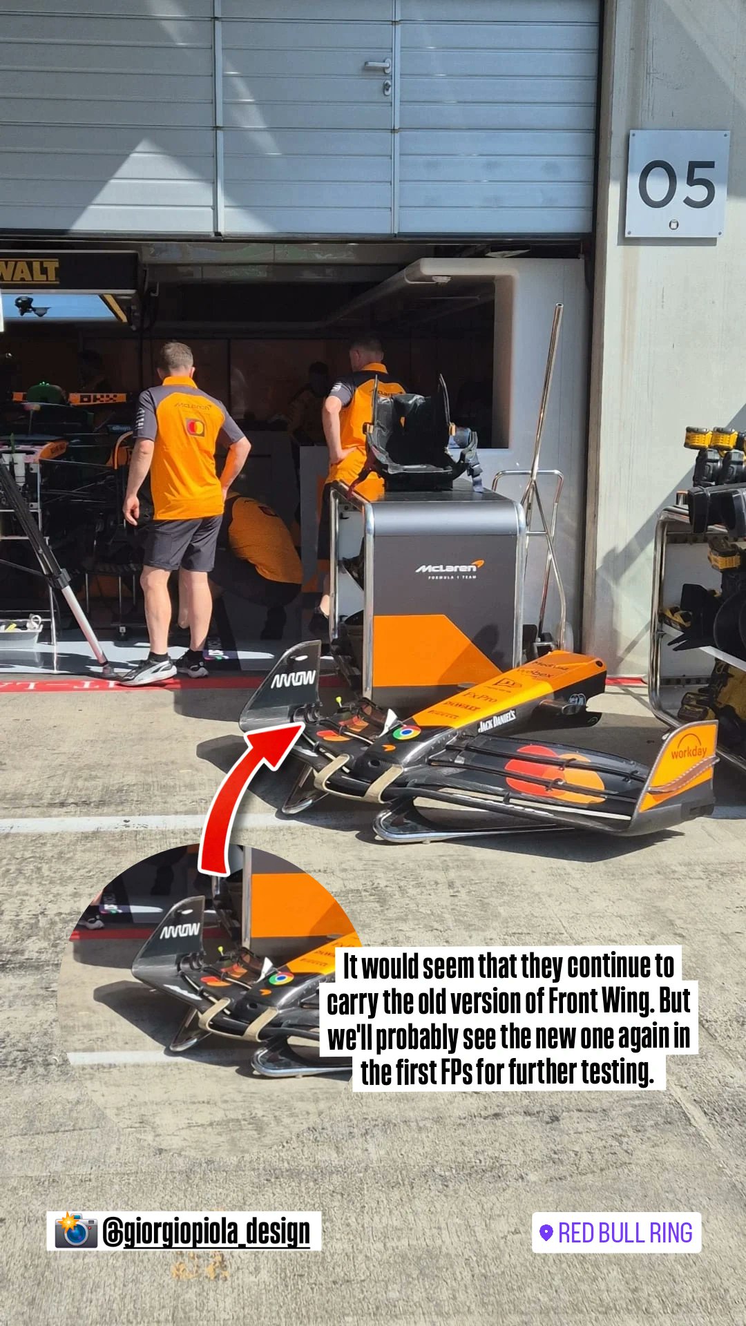

Im not sure i understand? this is completely standard practice, they will allways have old versions on display, it has been like that forever. That is not the same as reproducing them
SilviuAgo wrote:
Fri Jun 27, 2025 3:35 pm
Piola: McLaren still reproduces the old configuration of the front wing. But it will likely revise the new version in the first test sessions for further testing.
https://pbs.twimg.com/media/GuYzgHqX0AA ... name=large
I saw on F1TV also when they changed the FW on Alex car, so Giorgio might be right.

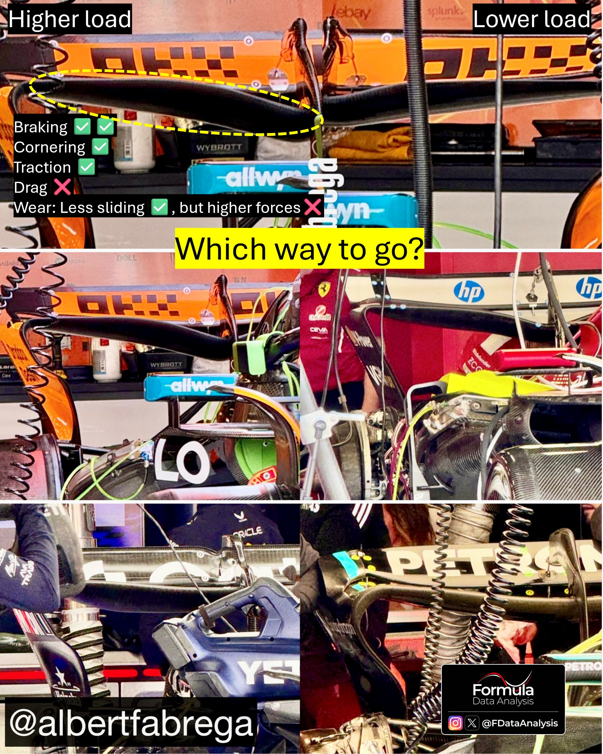

RW for Silverstone. Rain may change the load.
According to F1dataAnalysis, McLaren is still unsure about the best wing to run at Silverstone 💡
A MORE loaded wing (left) provides:
✅✅Much better braking (grip + stability)
✅Improved cornering and traction
❌Higher drag (main drawback)
🛞Will it result in better tyre deg? Yes... maybe
-The tyres will spin/slide less ➡️Smaller temperature spikes ➡️ Lower thermal deg
-Tyres will be subject to higher vertical forces, AND also longitudinal/lateral forces if the driver exploits the additional grip ➡️ Larger MECHANICAL stress. The AVERAGE temperature can get higher, increasing the mechanical wear (tyre gets softer) and the thermal wear too

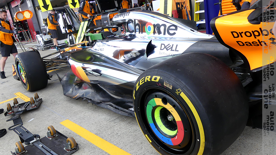

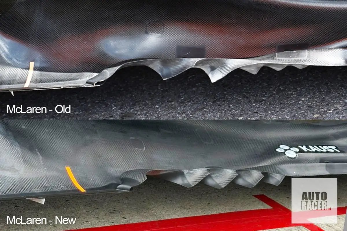

As expected, new floor

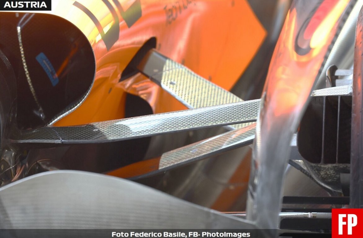

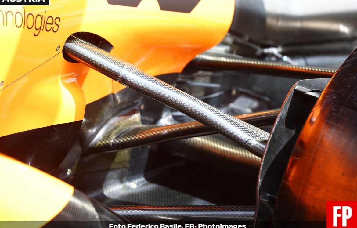

Here you go:
According to ThisIsFormula1, McLaren introduced coordinated updates to both the front and rear suspension of the MCL39 at the Austrian GP, aiming to address drivability issues in qualifying that had notably affected Lando Norris.
– The front suspension, refined further after its Canada debut, now features modified internal mechanics via the pull-rod system and new fairings on the suspension arms to improve force transmission and platform control.
– Alex Dunne conducted aerodynamic analysis with pitot tube-equipped rakes during FP1, confirming data collection on the front suspension’s airflow interaction.
– The rear suspension also received internal kinematic updates, likely designed to complement the front changes and balance bottom stability, tire behavior, and aerodynamic efficiency.

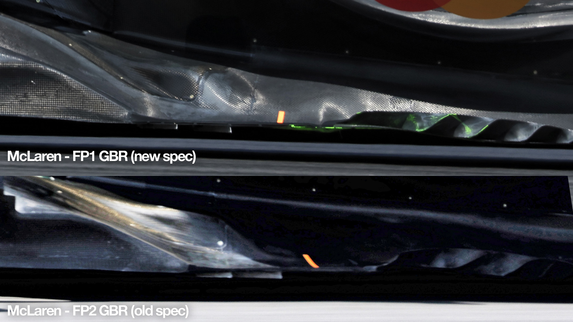

And few more, although McLaren decided to continue the weekend with the old spec.
