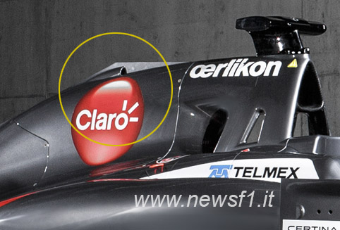

you look at this small air intake as it is placed in the F14-T perhaps for cooling the gear box or something similar to the power unit ferrari

zioture wrote:you look at this small air intake as it is placed in the F14-T perhaps for cooling the gear box or something similar to the power unit ferrari
http://www.newsf1.it/wp-content/uploads ... sauber.jpg
i mentioned that before, some think it may be to cool turbo, i personally think it's to direct air to the exhaust in addition to blow the monkeyseat. i think the slotted intake below the airbox intake is meant for turbo and electrical equipment cooling purposes.

Re: Sauber C33 Ferrari
Manoah2u wrote:we're gonna need some more shots of the sauber to actually be able to do a more proper analysis, especially from the back.
It's most certainly for cooling. It's highly unlikely they would be taking air from that location and ducting it to "blow the monkey seat".

zioture wrote:
http://www.newsf1.it/wp-content/uploads ... errari.jpg
This is like in Ferrari f14t
They're not the same type. Sauber is inlet Ferrari looks more like outlet.
It's an inlet. The way it's built it will take a fair amount of air in.
Yes but only on Sauber, look at this picture, it doesn't look like inlet on Ferrari, more like outlet.

Mr.G wrote:Yes but only on Sauber, look at this picture, it doesn't look like inlet on Ferrari, more like outlet.
http://papermodelers.sk/hostimages2014/ ... P66IES.png
I think Ferrari also has air vents is not output
looks good seems the air flow above and is captured is not ejected, Watch in photo (b) as the blade is at the center
Yes I know what you mean, but watch A. there it looks lite out. Puzzling, isn't it?
Mr.G wrote:Yes I know what you mean, but watch A. there it looks lite out. Puzzling, isn't it?
I think that now they try not to show everything.
Ferrari in previous years had an air outlet, so below 'maybe they have hidden this particular
Sauber's is a small inlet; likely to cool small stuff like electronics.
Ferrari's is a complex outlet which probably has an aero function too.
Zioture, air can't magically bend 180 degrees. the 2 aren't comparable and have a different function. Ferrari might or might not (probably not, because the sauber inlet looks to be part of the homologated roll hoop) add the same inlet, but that's guessing and hoping. Just judging from the launch pictures, there's a clear difference.
It's probably the complex structure of the Ferrari outlets that is confusing you. They are very well tuck away in bodywork.
