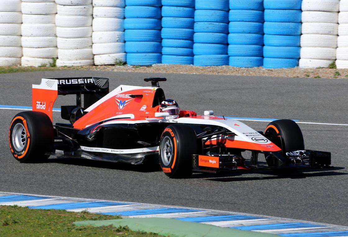

Oooh! That's a seriously good looking car. Looks proportionally balanced

Nice tapered sidepods. Not a lot of undercut, but the floor area behind the sidepods is quite big. A very sturdy base to build on.

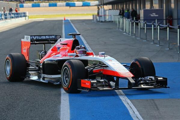

This has to be the nose Charlie has a problem with. You can see technically the front of the crash structure meets the regulations but in a real life scenario it will snap off and leave the traditional high nose crash structure to do the impact absorption.

Airbox looks big and split into 3 with a T shape divider splitting it into 3 intakes at top, bottom left and bottom right.

Really tight back end on it too! Well played Marussia!

Looking under the chassis: is it a slot?

are my eyes playing tricks or that Marrusia is really long?

But the chassi isnt high its 525mm.
