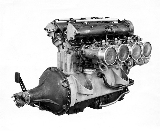

1954 FERRARI 553 2.5-litre four
From Aurelio Lampredi’s tipo 500 of 1953 evolved the tipo 625 once again the designation referring to one cylinder capacity. The car type was 553 nicknamed ‘SQUALO-SHARK’. The goal was for an oversquare that would be able to run reliably 7500RPM.
Cylinder head + water jacketing + the housing at front of camshaft drive were cast in Silumin alloy in 1 piece, cast-iron cylinder liners were screwed-up into combustion chamber, and hung down below the bottom edge of water jacking with the head/jacket unit being bolted down to top of a deep crankcase with liners a close fit and water-tight by rubber O-ring; bolting down to top of crankcase was by 8 long studs which emerged between the cam-boxes in center of engine.
The crankshaft ran in 5 Vandervell thin wall shell bearings. Full skirt and carrying 1 of the 4 rings bellow the gudgeon pin was an aluminum piston. At lower right and left side bolted to front of crankcase were the scavenge and oil pressure pumps.
A Fimac mechanical fuel pump was used. At both sides of the crank nose were the 2 Marelli magnetos resting horizontally pointing forward. Above the magnetos driven by a bevel gear was the water pump delivering water to engine through the center of the side of crankcase near the heavily loaded center main bearing.
A train of narrow gears from crank nose drove the twin camshafts. Large diameter camshafts were hollow with narrow cam-lobes working on shaft mounted rollers acting on upper face of a mushroom tappets, a single spring exerting 57kg compressed tappets against cam. 2 182kg-force compressed hair springs closed each valve.
The Squalo valve gear was tested as safe for 10000RPM. Inlet valves were inclined 40 degrees from vertical and the exhaust at 35 degrees. Tapering ports with 2 twin chock 58mm bore Webers being mounted on a small steel framework which in turn was bolted to the chassis to reduce float bowl frothing by vibration of engine, the carbs being connected to manifold by lengths of flanged rubber pipe.
Exhaust was collected from pairs 1-4 and 2-3 before merging into single tail-pipe. The magneto ignition of the time acted as a rev limiter limiting peak speed at 7600RPM. Lampredi’s liberties with piston speed limited piston reliabilities on the Squalo.
For 1955 the tipo 553 engine became the tipo 555 through detail changes and became the standard FERRARI racing engine installed in both the 625 chassis and the type 555 Supersqualo. It was at that time acknowledged that the magneto ignition provided would not allow the four to exceed 7500RPM.

re the Lancia D50 and its development by Ferrari .....
'a weak mid-range' may have been caused (as in the abandoned 1954 Coventry-Climax 2.5 litre F1 V8 ?) by ...
having the conventional 2-plane crankshaft the exhaust system couldn't get proper 'tuned length' effect in all cylinders
to remedy this Ferrari fitted 8 separate pipes (as crossover exhaust system don't fit front-engine cars)
