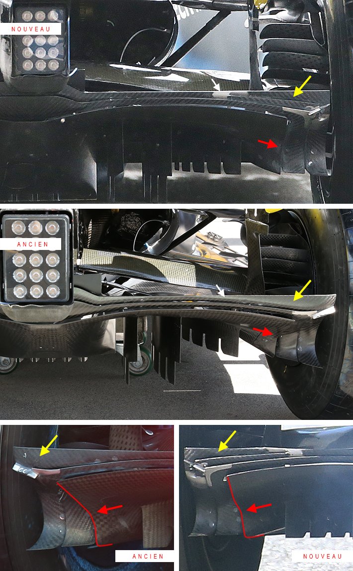

Nicolas Carpentiers wrote:In addition to the new front wing design and bargeboard additions, Renault F1
brought in Austria a new diffuser, with an additional cut in the upper flap (compare yellow arrows) and an different shape (see red arrows).
