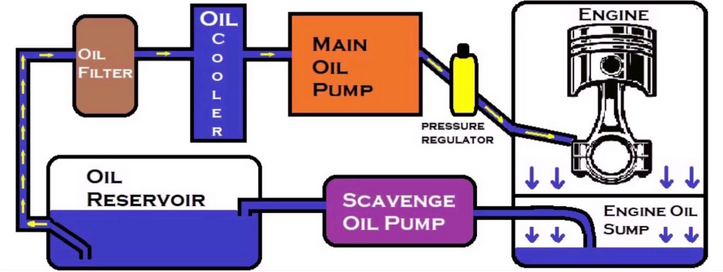

An F1 engine uses what is called a dry sump oil system. This is different to a normal road car where the oil is contained in a ''wet sump'' located at the bottom of the engine. This system is shown below - oil is filled in the top of the engine and finds its way to the sump. As the oil drains from the engine bearings and cylinder head it flows down and back to the sump under gravity. It is then filtered and pumped around the engine again. This system is cheap and closed loop. However, because large quantities of oil sit very near the crankshaft this can cause large power losses known as windage whereby the oil sloshes around and hits the crankshaft slowing it down.
In a dry sump system, the oil tank is located away from the engine and the oil sump becomes more of a collection tray for used oil that is expelled from the engine bearings during running. Oil collection pumps called scavenge pumps are located along the shallow oil sump collection tray. These collection pumps have two purposes in basic terms - to collect the oil that has collected in the tray, and also to collect blow by gasses - the combustion gasses that make their way past the piston rings. This is a bonus in terms of power as blow by gasses can collect in the sump and increase pumping resistance of the pistons above them. The scavenge pumps do the job of making sure all this pressurized gas is removed from sump so that sump case pressure is not an issue.
A basic layout of the dry sump system is shown below,
