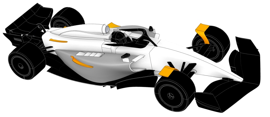

This is the car for the last race at the Silverstone circuit.
I hope it's enough to be on the podium.

You had fun with winglets!
Those on the wheels should bring quite some performance.
Let's see if G-Raph manages to regain momentum and defend his podium position.

variante wrote:
Sun Dec 18, 2022 2:10 pm
Yes, finally and only for the last race, I made an exception, derogating from the principle of having a legal F1 car.
