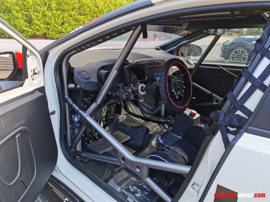

Arguably, unusual roll cage designs in saloon race cars are interesting, even if it is an aspect of a saloon racing car that probably doesn't make all that much difference to performance (probably with no "correct" solution and alternative designs probably having no real advantage over what one might call a "conventional" design?). It's interesting to see roll cage designs which are different than the norm IMO.

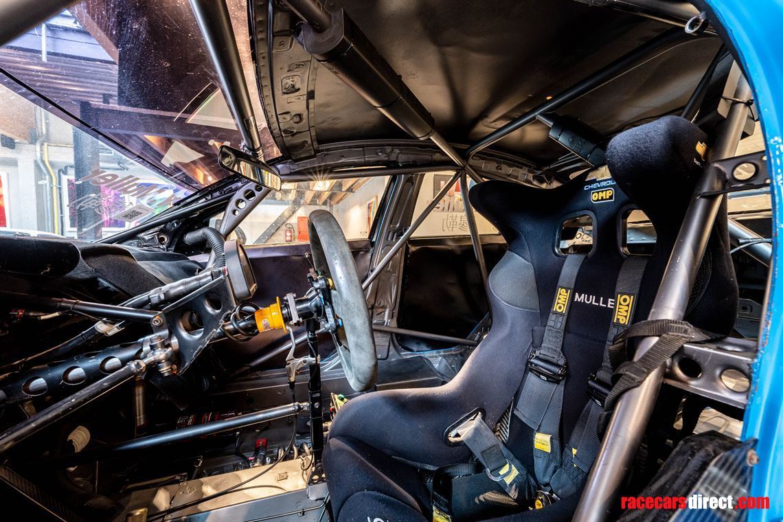

Here's the RML Chevrolet Cruzes from the WTCC with their unique not-door bars running to the top of the main hoop:

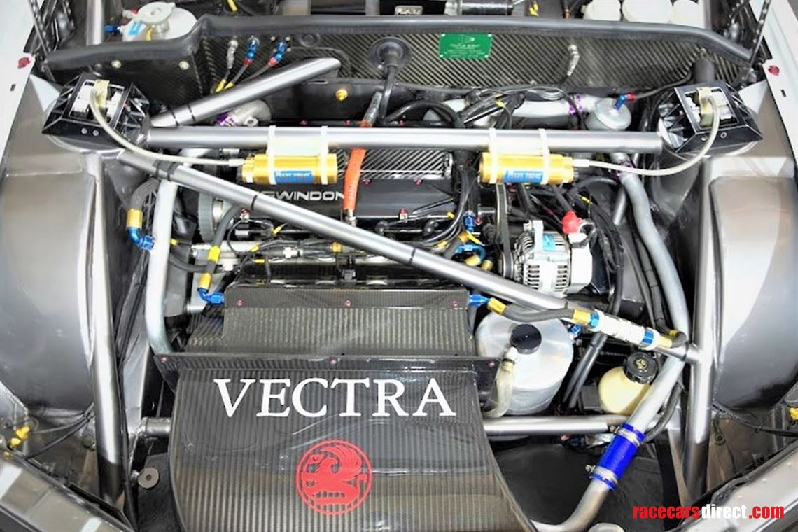

This 1995 Vectra super tourer has quite a substantial amount of reinforcement of the engine bay indeed! It seems like it would make installing the engine, albeit done from underneath, quite a pain!

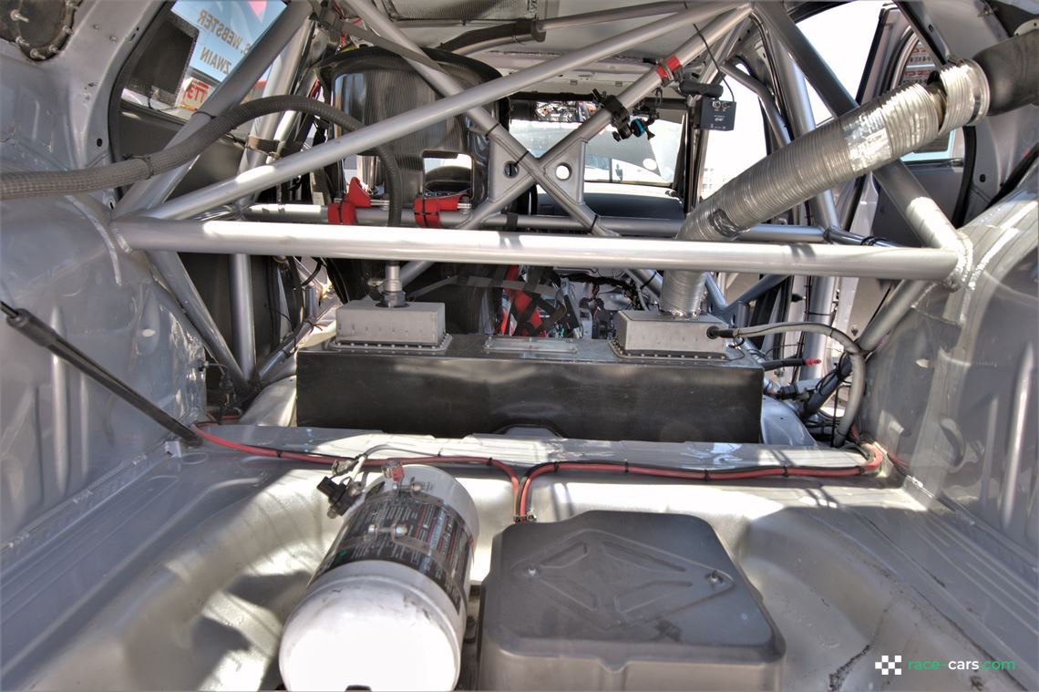

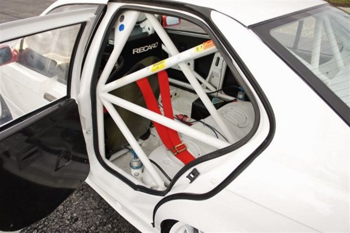

Here's the extra triangulation around the C-pillar of Prodrive-built cars from the 90's and early 00's. The example is the Prodrive-built Super Tourer BMW but Prodrive-built Subaru WRCars used a similar design:
