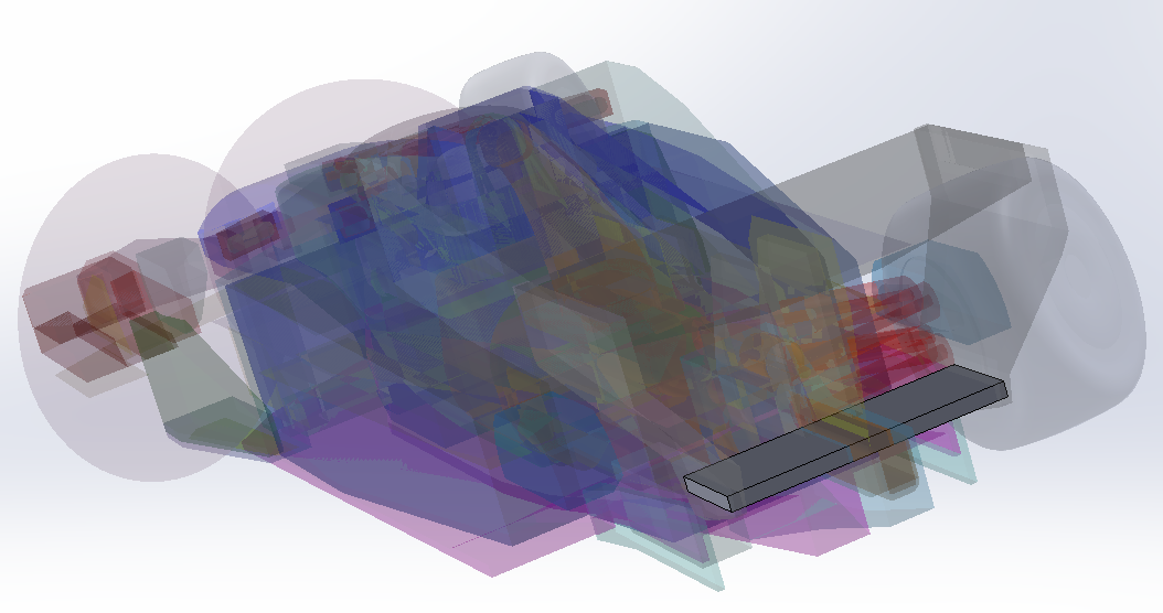

Finally here is the "beam wing" ("brace"):
Considering the small allowed volume, the role of the beam wing is more of a structural support for the side bulkheads of the rear wing. You'll find this volume in the next release, along with small changes that go in the direction of more freedom for the front suspension (permissible volume cylinder radius increased by 5mm) and a small reduction in the rear clearance of the rollbar.
