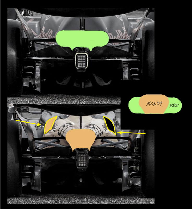

I'll attempt a non-brake-duct related explanation for Mclaren's performance. The MCL39 has numerous features which none of the other teams have in full:
narrow engine cover
small cannon exit
narrow front nose
venturi RW stay (speculative; see below)
most sophisticated internal aero
highest cooling outflow velocity
possible wing-flex DRS
multilink upper suspension arms
totally unique steering arms & internal rack linkages
RB18+ floor fences
RB18+ reference plane steps (“boat”)
RB18+ general suspension layout front & rear
RB18+ sidepods
RB20 shark mouth inlets
The size of the cooling outlets indicates that Mclaren have the highest cooling outflow velocity. Greater velocity allows them to move the same air mass through smaller outlets. It is evindent in some photos that the MCL39 has the most developed internal ducting; that’s the secret there, which is to say, nothing really to do with the radiators themselves nor the power unit or the coolant, all of which are so regulated anyway that I can't expect them to be performance differentiators on their own.
One unique part they have is their rear wing stay. It resembles a venturi duct. Cooling outflow would be drawn, heated, then expelled. Speculatively that might impart greater velocity to that parcel of air. Important beneath the rear wing. The quicker the radiator outflow, the more invisible it is in terms of the wake passing throught the RW/BW/diffuser area, improving the efficiency of all the rear aero. Compare to the RB21 whose stay has has a smaller gap to the exhaust pipe.

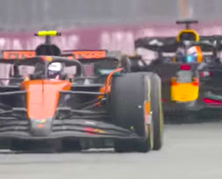

At the front, they have a narrower nose than the RB21. This effectively gives them larger front wing legality boxes, which they can use to make bigger wings that increase downforce or to simply run a wider and vertically shorter wing with a better aspect ratio.
Given how well they’ve designed several parts of the car, it stands to reason that they also have very good if not the best brake duct performance--but the brake ducts are only one piece of the puzzle; perhaps their proximity to the tyres is leading to a false association.
More efficient front wing, least disruptive cooling outflow, maybe some wing-flex DRS... In short, the MCL39 probably has the best lift:drag ratio of all the cars. In practice, they could achieve similar downforce levels with less drag, or greater downforce levels without increasing drag, relative to their competitors’ cars. Reducing the drag force reduces the overall stresses endured by the tires, thus providing slightly cooler tires that last slightly longer, and by association offer a broader operating window i.e. the drivers can go more aggressive to get the quick heat-up which the drivers of other teams cannot risk i.e. the operating window has a higher peak transient temp tolerance because they always have a ‘normal’ or ‘preservation’ driving speed that heats the tires less, due to reduced drag forces put through the tires. Mclaren’s tire management may just be a result of the RB39 being the sum of its well-honed parts. Mclaren took the good practices of the RB18 series cars and polished them further.
As for PCM in the brake drum/tin, there could only be a small amount in that thin walled part, maybe 100 cc at most. So is it more that thermal conductivity changes, and nothing to do with thermal mass, per the hypothesis? As for bi-metallic strips acting at louvres/doors/vanes, that would be moveable aero, too easy to identify, ban, and risk DSQ.

vorticism wrote:
Wed May 14, 2025 6:33 pm
Is this accurate? Mclaren has additional outlets further forwards on the left and right side which you have not highlighted. They are not "small". There must be mass continuity so the airflow from the rear exit is not automatically "higher". Some of the air mass has exited already from the pair of outlets located further forwards. Therefore, assuming the two cars have similar heat rejection requirements and similar internal losses, it is not apparent that Mclaren would have much "greater" cooling exit velocity from the central cooling exit at the rear.
334
Joined: Tue Mar 01, 2022 7:20 pm
Re: McLaren MCL39
Thu May 15, 2025 3:10 pm
Is this accurate? Mclaren has additional outlets further forwards on the left and right side which you have not highlighted. They are not "small". As there must be mass continuity, then the airflow from the back is not automatically "higher". The Red Bull does not have forward exits in that picture. So assuming similar engine/intercooler heat rejection requirements, I don't think it's straightforward to say one car automatically has higher cooling exit velocity.
The drawing is accurate to the extent the images are the same size scaled to the common exhaust pipe diameter and rain light size. As for the hypothesis, it is what it is. The MCL39 louvers are smaller in area than the green spaces in the cannon comparison, and this includes after the cannon height difference is also removed from those green spaces, which is to say, the total outflow area of the MCL39's combined louvers and cannon is smaller than RB21's cannon. Both cars utilize lower suspension arm portal outlets so these were not considered.The total MCL39 cooling outflow area may be something on the order of 95% of the RB21. Also I did not include the RB21's spine outlet, which when included should favor estimation errors toward the hypothesis.
I compared cannon outlet sizes because the cannons are in closer proximity to the RW. The louver outflow will be accelerated by the local/ambient free stream thus that % of the cooler outflow is reduced in terms of its influence upon the RW/BW/diffuser vs. had they expelled it right in front of the RW like RB. Consider the '22 Ferrari did this in the extreme with all louvers and no cannon.
