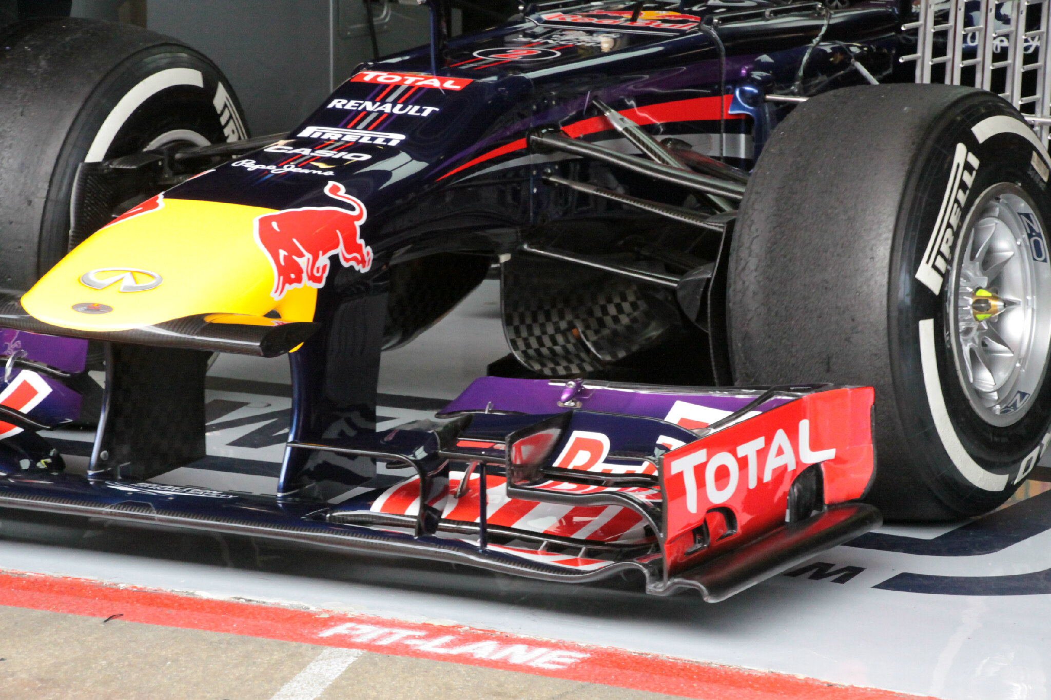

RicerDude wrote:http://www.f1fanatic.co.uk/wp-content/u ... G_1437.jpg
New vanity panel and FW endplates?
yes updated endplates for sure
Cascades too.

Lower nose for sure also.

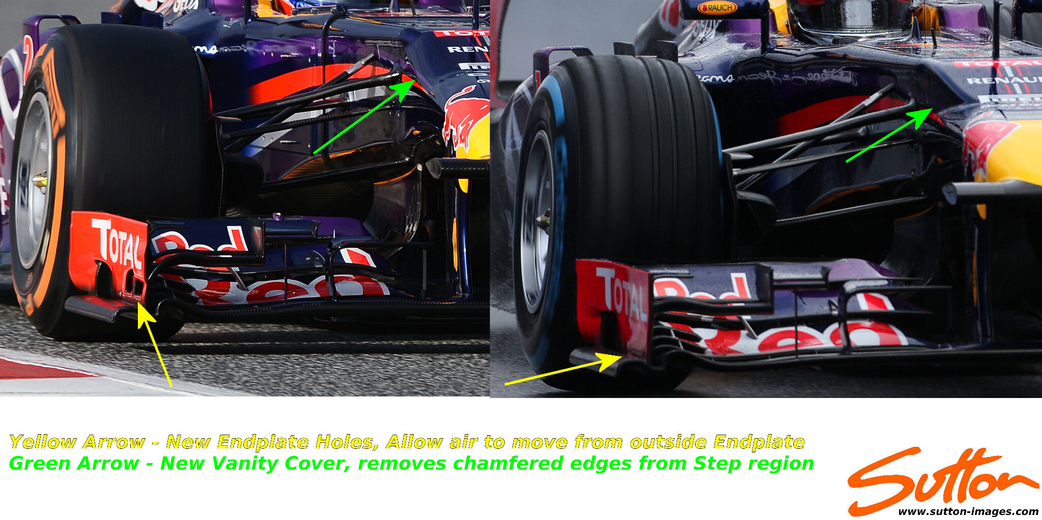

Matt Somerfield ‏@SomersF1
Red Bull RB9 - New Nose / Vanity Panel (The Noses step has been widened) via Sutton Images
Red Bull RB9 - New Nose & Front Wing Endplates, Extra holes in the Endplate and Step Nose lost chamfered edge
High resolution: Front | Back end / Exhaust

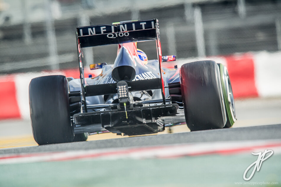

Another air opening just below the Renault logo on engine cover.
Red Bull RB9 - New Nose & Front Wing Endplate side by side comparison with old including explanation of changes
via Andrew Benson/Gary Anderson

Looks like they put a gurney on the beam wing as well

dxpetrov wrote:Another air opening just below the Renault logo on engine cover.
Zoom in. That is just a reflection! #-o
There is a new opening indeed

Any idea what it can be for?
204
Joined: 23 Feb 2008, 17:55
Re: Red Bull RB9 Renault
I'd say it is just cooling, leaving the exit around the gearbox only there for the tunnel air.

Blackout wrote:
Jameypricephoto
https://pbs.twimg.com/media/BEXXtcECYAAqZtB.jpg:large
Sorry. I thought that he was referring to the apparent opening at the front end of the renault sticker. Couldnt see any other sign of an opening. Should have gone to Specsavers. :oops:
