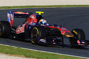

With STR now (in terms of the technical department) independent of RBR tech, do you guys think the STR6 will be based on their STR5 design, or the RB6?

STR no doubt.

Why though? Using the RB6 as a base would have proved a far more competitive base to work off from rather than the STR5. That was my point. Sure, the STR5 was ok and it's got characteristics the current two drivers know and have learnt to set up. But surely Dietrich Mateschitz wouldn't object to the few extra bucks that he could get by using the RB6 as a base for the STR6... no?

But they are not allowed to use the RB6 design since they became independent manufacturers, are they? From what I gather, they had Intellectual Property rights to the RB5/STR4 design and so could use it as a base for this years car but have no such privilege with regards the RB6, but I could be wrong?

We would have to see how the regulations are phrased as I believe there is nothing to prevent teams from purchasing consultation rights and techniocal data from external contractors (e.g. Force India/Lotus working with Aerolab) as long as the actual design work is performed in house.
I reckon that this is a loophole big enough to hang yourself.

STR have no rights to the RB6 design info, the STR5 was al their own work, albeit starting from the RB5 based 09 car. Even through last year they had their own independant R&D team, with Designers, Aerodynamicists, CFD, model makers and wind tunnel people. By the seasons end they STR5 was quite a different car to the launch version, so a lot of independant thinking goes on there.
