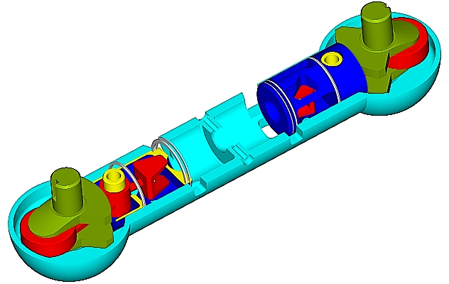

Quote from http://www.pattakon.com/pattakonPatAT.htm

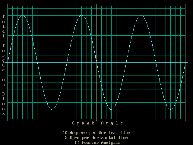

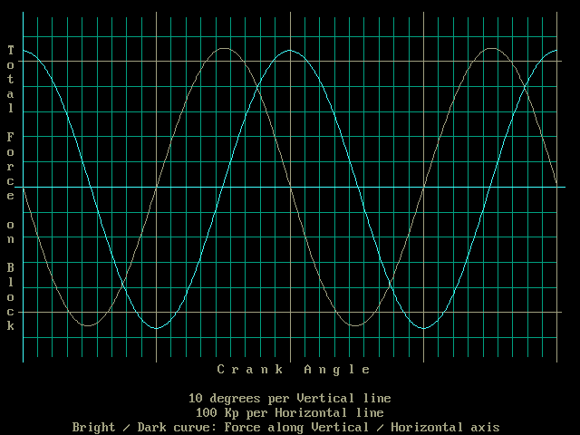

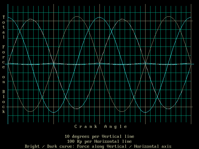

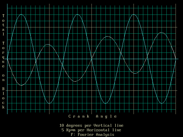

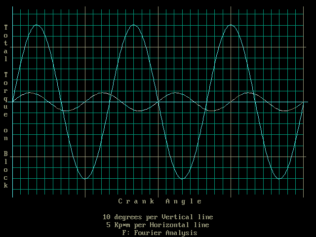

The following even-firing Cross-Radial:
is as vibration free as the best V8, it has firing intervals equal to those of a V8 four-stroke, it has four-stroke lubrication (plain bearings, forced / splashed lubrication in the crankcase, oil scraper rings), it can utilize a central scavenging pump (a turbocharger, for instance), etc.
In the above animations they are shown the moving parts of a Cross-Radial PatAT from various viewpoints. The connecting rods and the pistons are properly machined to provide wide bearing surface wherein the heavy loads are taken, keeping at the same time the piston bore low and the crankpin short. A single plane bearing (the yello part around the crankpin) serves all the connecting rods "unconventionally" (it rotates inside their big ends, being secured to the crankpin).
In comparison to the convetional Radial engine:
the Cross-Radial with the four cylinders and with the forked connecting rods is a true "vibration free" engine (better balanced than the "master-slave-rods" Radial regardless of the number of cylinders of the later), it is also a true "symmetrical" engine: all the four cylinders run under the same conditions: same piston stroke, same piston motion profile, same connecting rod leaning (thrust loads), etc.
As the Radial.exe demonstrates, a typical Radial (master rod / slave rods) cannot help running with substantially different piston strokes in different cylinders.”
End of Quote.
More important than the uneven firing is the uneven way the various cylinders of a conventional Radial operate. With the master cylinder arranged at the top of the conventional Radial engine, the pistons in the “side” cylinders perform a stroke of about 10% longer than the stroke of the piston in the “master cylinder”, with the cylinders at the one side compressing substantially faster and with the cylinders at the other side expanding substantially faster.
The 2-stroke PatAT Cross Radial turbocharged Diesel:
is both: even firing (90 crank degrees between consecutive combustions) and perfectly “uniform” as regards its cylinders: the reciprocation performed by a piston is identical with the reciprocation performed by any other piston.
It is also more “vibration-free” than the best 4-stroke V-8 engines.
As for the Radial PatRoVa:
There is a front cross (comprising the two vertical and the two horizontal cylinders) wherein all the four pistons, by means of four forked connecting rods, use the same crankpin of the crankshaft, just like in the previously described 2-stroke PatAT Cross Radial.
According the previous analysis of the Cross Radial 2-stroke PatAT, each Cross alone is “perfectly balanced” and its pistons perform the same exactly reciprocating motion (same stroke, same piston motion profile, same leaning of the connecting rod relative to its cylinder axis etc).
At the back cross (comprising the four diagonal cylinders) of the eight cylinder PatRoVa radial. The bottom left cylinder is at its TDC (at its TDC is also the top cylinder of the front Cross), i.e. the crankpin of the back Cross is 135 degrees apart from the crankpin driving the pistons of the front Cross.
Is it now obvious that this 4-stroke Radial is even-firing?
The “asymmetry” of the crankshaft (the two crankpins are at 0 and 135 crank degrees) doesn’t matter at all, because each Cross, alone, is “perfectly balanced” as regards its inertia vibrations.
Putting the two Crosses at 45 degrees from each other, what you get is the uniform cooling of all cylinders: the front ones and the back ones.

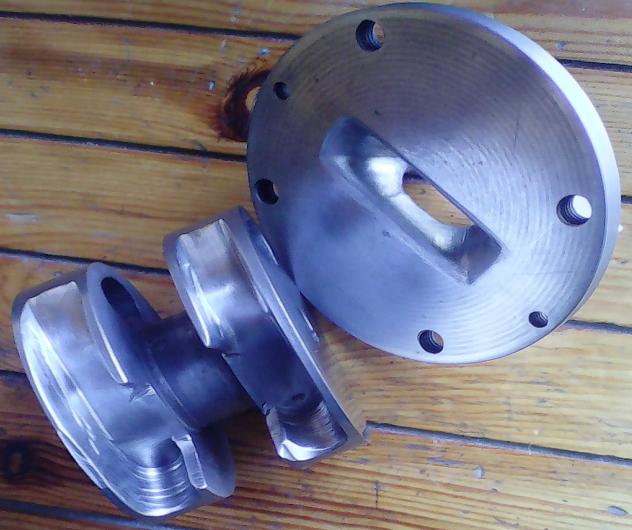

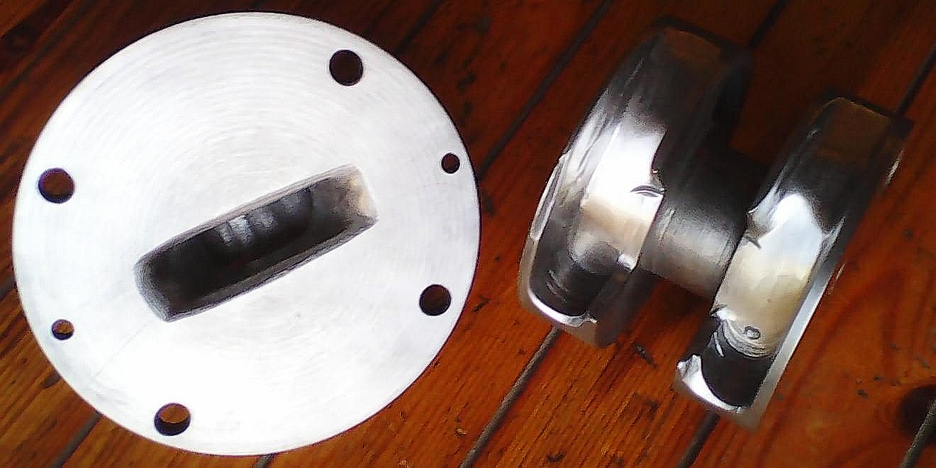

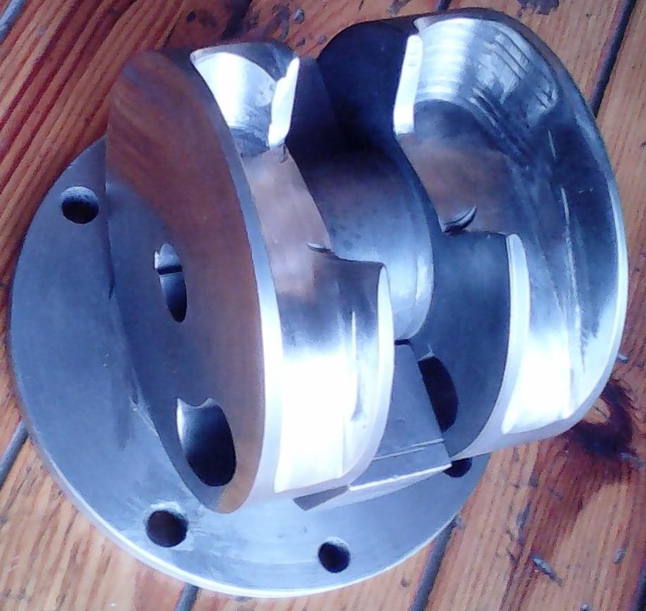

The simple structure of the valve train (one moving part per cylinder and nothing else, with the “one moving part” performing a smooth rotating motion) and the fact that the valves can never hit the piston, enhances the safety.
So, take another look on this 4-stroke 2-row Radial engine with the PatRoVa rotary valves on its heads and find disadvantages.

The PatRoVa rotary valve is a true Desmodromic valve train wherein the rev limit is more than double than the rev limit of any Desmo / Desmodromic system:

(Imagine optimizing (in terms of volumetric efficiency, of emissions, of vibrations, of rev limit etc) a 4-in-line conventional auto-engine having different strokes in the four cylinders.)
Then press the c key on the keyboard. The brown radial line represents the overall inertia force resulting by the motion of the pistons. Depending on the angle of the crankshaft, it varies significantly, which means the two balance webs on the crankshaft cannot completely counterbalance it. Not good if you want to use the most lightweight frame.
With four cylinders per row you have perfect vibration-free quality.
The same is true with five, seven, nine, eleven etc cylinders per row, but it becomes from difficult to impossible to use conventional connecting rods (and not master-slave ones which generate significant problems as explained).
In a single row 4-cylinder PatAT turbocharged Diesel, the asymmetric transfer of the PatAT helps the turbocharger to efficiently scavenge the cylinders and to trap into the cylinders a lot of air.
The transfer gets as asymmetric as in the Opposed Piston engines (Junkers Jumo, Achates Power etc), without the side effects of the conventional Opposed Piston engines (heavy crankshafts, heavy synchronizing mechanism, friction, cost, compactness etc).
The PatAT is a 2-stroke, however it has 4-stroke lubrication of the crankcase and of the lower side of the cylinder liners wherein the thrust loads are taken (the oil scraper rings never pass over ports), which reduces the friction and the specific lube consumption.
See in the animation the yellow plain bearing under the big ends of the four connecting rods.
A single plain bearing can serve all the four forked connecting rods.
As you see, a 2-stroke PatAT Cross Radial turbocharged Diesel concentrates a lot of significant advantages and avoids several disadvantages of the prior art aero engines, making it a good solution for airplanes, light airplanes, helicopters etc.
Objections?
Thanks
Manolis Pattakos

Here are the plots of the free inertia force and free inertia torque of a conventional Radial-3 with forked connecting rods (not master – slave, forked):
Here is the comparison of the above Radial3 with a V90 2-cylinder (like, say, a Ducati Panigale Superleggera) for same bore, same stroke, same connecting rod, same piston:
The unbalanced inertia force of the Radial3 is a rotating 2nd order force, while the unbalanced inertia force of the V90 2-cylinder is “flat”, on a plain normal to the bisecting plain of the Vee.
The unbalanced inertia torque of the Radial3 is about double as compared to the unbalanced inertia torque of the V90 2-cylinder (OK, with same bore and stroke the V90 has the 2/3 of the capacity of the Radial3).
The only advantage of the Radial3 is its even firing (120 crank degress if 2-stroke, 240 crank degrees if 4-stroke).
And here is the comparison of the free inertia force and free inertia torque of the Radial3 versus a Radial4 (say, the PatAT Cross Radial):
The free inertia force of the Cross Radial is actually zero (while the Radial3 suffers from a heavy rotating 2nd order unbalanced inertia force).
The free inertia torque of the Radial 3 (it is of 3rd order) is several times (almost ten times) bigger than the free inertia torque of the Corss Radial 4-cylinder (which is of 4th order: count how many times it maximizes during a complete crankshaft rotation).
Provided the connecting rods are forked connecting rods, as in the PatAT Cross Radial arrangement (the forked connecting rods eliminate the inertia moment of a Radial), according the math and the physics the Radial-4 (or cross radial) is almost perfect and you gain nothing to go to more cylinders (except the smaller intervals between successive combustions).
As you see, the transition from a Vee90 2-cylinder to a Radial3 is not an improvement, or, at least, not a clear improvement.
According the theory, a V90 2-cylinder appears not inferior as regards its vibration-free (inertia vibration-free) quality relative to a Radial3 of the same capacity.
In comparison, the transition from a V90 2-cylinder or from a Radial-3 to a Radial-4 (or Cross Radial) is a substantial improvement as regards the vibration-free quality. And because the Cross Radial 4-cylinder is almost perfectly rid of inertia vibrations, more cylinders add nothing to smoothness.
