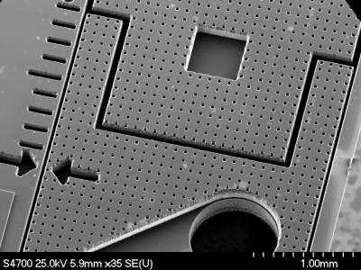

Another example: the US Air Force is working on what they call MEMS, which are miniaturized sensors that are being tested to sense the temperature at turbine bearings. The sensors are located inside the rotating bearing, ruling out a wired sensor or, at least, providing evident advantages if you use a wireless one.
Micro Electro-Mechanical System: it has ears and arms (the mechanical part) etched in silicon
The little sensors are fed electricity through an induction coil that picks a radio signal and convert it into electricity (more or less in the same way the supermarket "thief alarms" work). You have to energize them somehow: if you have to use a wire to provide electricity for the sensor to work, what's the point of the communication wireless channel? Advanced wireless micro-sensors to prevent jet, spacecraft and car engine failures
