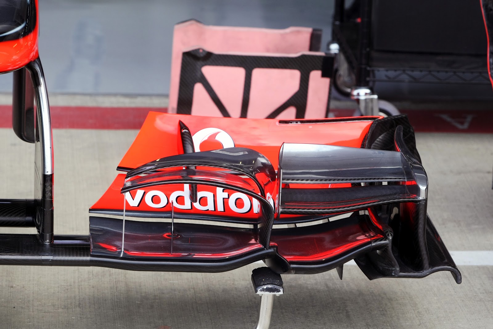

Are you sure about that? Frankly, I see very little in common between this digital representation and front wings that have actually raced. Moreover, not only does the model lack wheels - what isolationist thought that was a good idea? - it also shows no sign of flexing, which was/is a substantial factor in the end plate's ability to deflect air flow around the wheels, nor is it equipped with cascades.
I think this front wing is a Formula One front wing in much the same way Dame Edna is a woman.
Real wings:
Each of those wings has so-called "outwash" end plates. In fact, this feature played a prominent role in Brawn's early success in 2009. The field didn't start catching up until they'd developed their own "outwash" front wings. That lets us know the loss of surface area associated with this feature is well worth the reduction in drag from the front wheels.
BGP 001 (fast)
MP4-24 (not so much)
hardingfv32 wrote:[...]
You would think that the wing would initiate the early stages of this outward flow direction without the help of the wheel
Why would one think that? Does it make sense to give the wing additional drag when you're just going to throw a heaping helping of drag right behind it anyway? Since you can't avoid it, might as well use it for something.

Post Wed Aug 15, 2012 12:55 am
Well, for a start, the student made the following statement:
At the time of the project (end of 2009) the new FIA's regulations for the upcoming racing season (2010) was not yet all disclosed and revealed (e.g. many technical drawing where missing on the regulation itself) so I had to work really hard also in the Regulation understanding & interpretation process)
The geometry as not been optimized due to a lack of time (as it can be seen in the 2d graphics results the flap stalls)..a better design should be evaluated.
So, he didn't know the regs properly and he admits that the geometry needs further work.
Looking at the chosen design:
I would suggest that there is an indication of an outward flow endplate there. I also note how the aerofoil separation distances are far from representative of a real front wing. Also, as noted elsewhere in the thread, the lack of a rotating wheel behind the wing removes a major factor in the flow of air around the wing.
This piece of work definitely can not be used as a way of justifying a non-outward flow endplate. It's just too basic a piece of work (with all due respect to the student who has otherwise obviously worked hard on his thesis and I applaud him for that).
Back to the original issue - the current wide front wing suffers from the front tyre interupting the free flow from approx. 30-40% of the active downforce producing surface of the wing. Thus any wing / wheel interaction will endeavour to do 3 things:
1. reduce the lift experienced by the tyre as this is working against the downforce and reduces the net grip available
2. reduce the drag caused by the tyre
3. increase the extraction of air from below the front wing (sometimes called scavenging the flow).
The flow coming off the front wing can go three ways: outside the tyre, over the tyre, inside the tyre.
We have seen, in the paper quoted by bhallg2k, that flow over the front tyre increases front tyre lift and drag. This is obviously not a good choice.
Directing the flow inwards is shown to be beneficial in the paper but it must be remembered that the paper talks about the 2009 front wing (i.e. the short span wing). That wing placed the endplate approx. in front of the inner shoulder of the front tyre. It makes sense in that situation to direct the flow / vortices inwards of the tyre because otherwise you have to get sufficient energy in to the flow to turn it through approx. 80deg and get it across the moving face of the tyre. Look at the McLaren front wing of the period to see how they obviously designed the endplate to direct air inwards.
The -23 is on the right. See how they sacrificed ultimate wing area to allow an inward turning endplate (which gave a large footplate too which is also probably beneficial to the overall efficency of the front wing).
So we are left with the option of turning the flow outwards around the tyre. Look at the current endplates and you see that they are designed to turn the flow outwards:
Indeed, looking at the current McLaren wing, it appears to me that the cascade wings on top of the front wing are, in part at least, designed to help the outward flow. Look at the inboard of the two cascades and you can see that the long radius bend has a long, heavily cambered, chord that appears to be trying to direct air outwards. The apparent close coupling of this section and the outer cascade suggests that the outer one is being used to help drive the turning effect of the inner cascade. The endplate itself is split in two with the main, inner section having a marked outwards bend to it. This will direct air outwards (as well as increasing the expansion of the volume below the outer most part of the front wing). Note also how the endplate has been brought inwards to give a large footplate again - this is obviously an important part of making the wing work effectively.
I think there can be little doubt that the current methodology is to turn the flow outwards around the front tyre.

It's a full width wing, yes, but it is not at all representative of a current F1 wing because of the design of the elements and their relative positions. The wing also utilises formal inner endplates where current F1 cars do not generally do - they usually have tapered tips to the aerofoil sections. Also, the lack of a wheel behind the wing rather reduces the relevance of the indicated flow structures behind the wing.
There isn't a single vortex behind the wing (here being a set of three aerofoils set between a simple inner endplate and more complex outer endplate rather than the whole wing). There are two vortices, one each from the outer endplate and the inner endplate as you would expect. But there is no wheel modelled so they interact in a way that isn't at all representative of a real car - they are effectively drawn together in this model because each is a low pressure region relative to the free stream around them. As the inner endplate is simpler and appears to be less effective in reducing the inherent vortex, I would suggest that the inner vortex is stronger (has a lower pressure) than the outer vortex and hence the general trend is for the outer vortex to move towards the inner vortex - in this model.
On a car, the inner endplate vortex might be expected to travel between the wheel and the chassis and interact with one or a combination of, the flow under the the nose; the flow around the 'tea tray'; the flow around the barge boards; the flow around/behind the tyre. None of those is present here so those interactions are not modelled.
The vortex from the outer endplate would hit the tyre's shoulder/outer part of the tread. Again, the tyre is not present in the simulation so this interaction is not visualised.
As the inner endplate flow will travel as noted above, the outer endplate needs to deal with its vortex in order to reduce overall drag, reduce tyre lift, increase front wing effectiveness.
Now, which is the best way to deal with the vortex from the outer endplate? Send it outwards around the outer shoulder and then have a useful vortex to do work behind the tyre? Or try to send it inwards across the entire surface of the tyre and try to get it to flow off the tyre's inner shoulder and then be useful thereafter? I think the way I've framed that question points to the answer.
So, to answer your final question. You tell me: does the outer endplate route the flow? Generate a vortex? Both?
Hint: the answer is "yes" to each of those questions. And it also helps to improve extraction of air from below the wing in order to improve front wing downforce. By improving downforce and reducing overall drag the endplate improves the efficiency of the wing. And by careful design it should be possible to set up flow structures that have a beneficial effect on the rest of the car e.g. flow along the floor's edge, flow towards the exhaust/diffuser region etc. Indeed, these flow structures are very evident in the images posted by bhallg2k.
