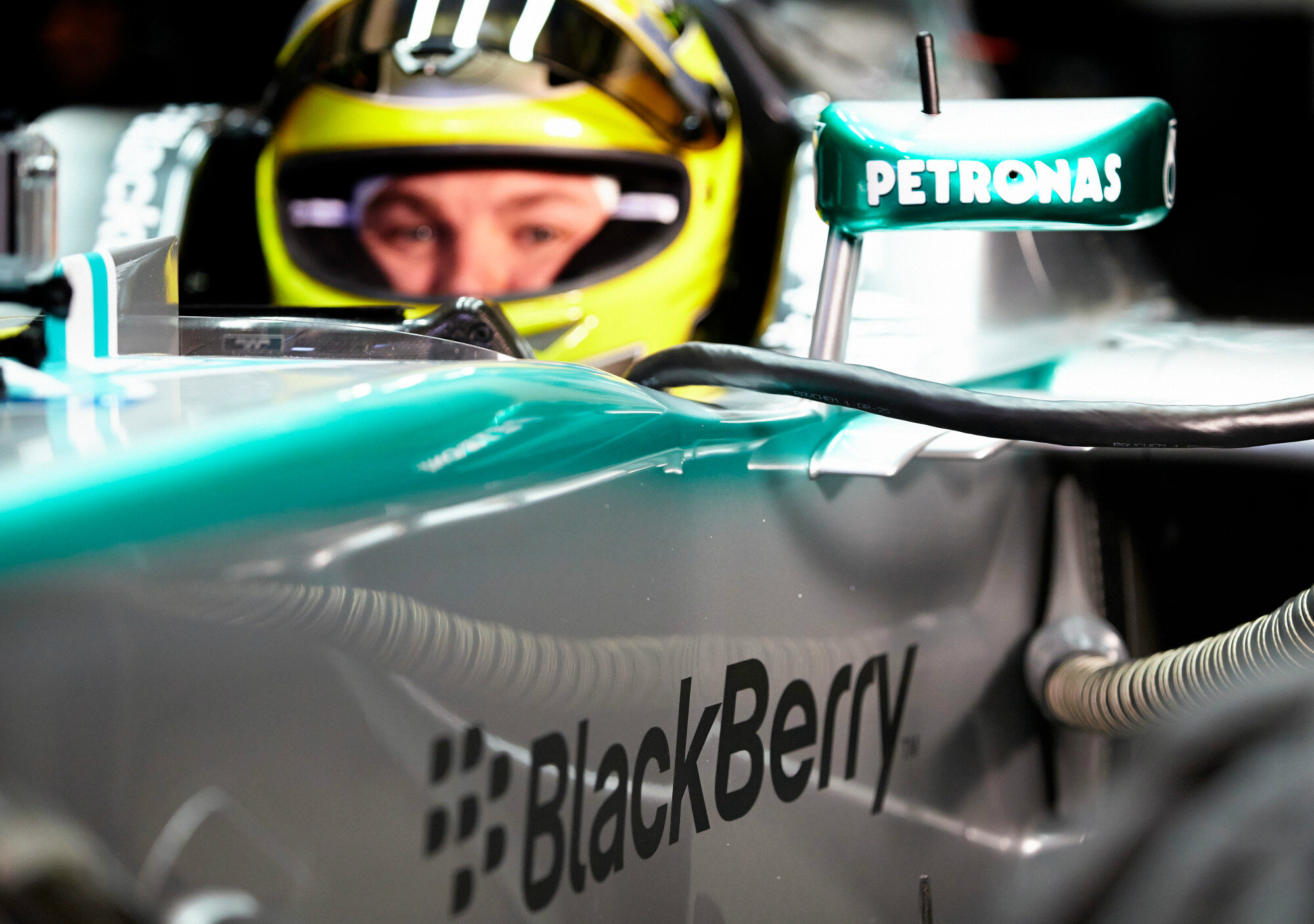

To check that every thing is working as expected, they had better put a couple of thermosensitive stickers on the gearbox and crash structure (see picture).

So are you saying they dont need the inlets to cool kers any more (in which case they wouldnt need to cool them like they are doing in one of the pics, with the blower), and are using them to energize flow coming out the back, or that the effect is in addition to cooling kers? Anyway, it´s a nice brainstorm, you could be on to something here!
Just to add to the topic, last years piping you are talking about:
Not exactly touching the exhausts, but close enough to get very hot indeed.
