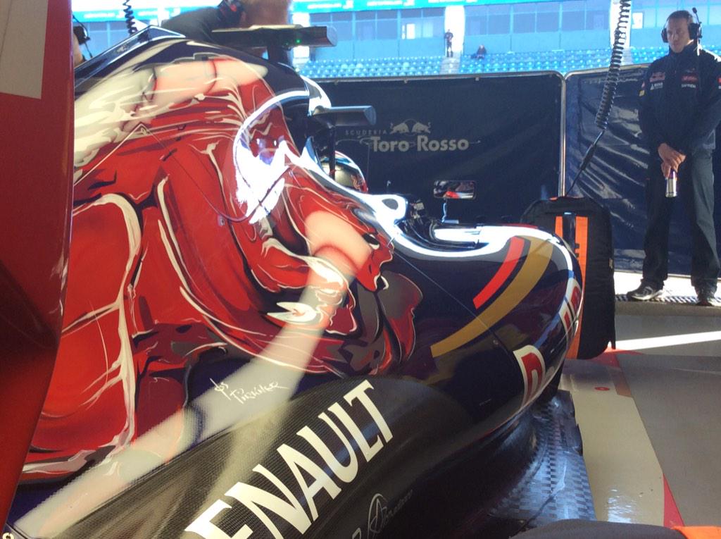

Re: Toro Rosso STR10
Pretty cool angle, from their twitter.
