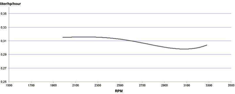

Specific fuel consumption with full throttle:
which gives 310gr/kW/Hour (which means 27% Break Thermal Efficiency at peak power).

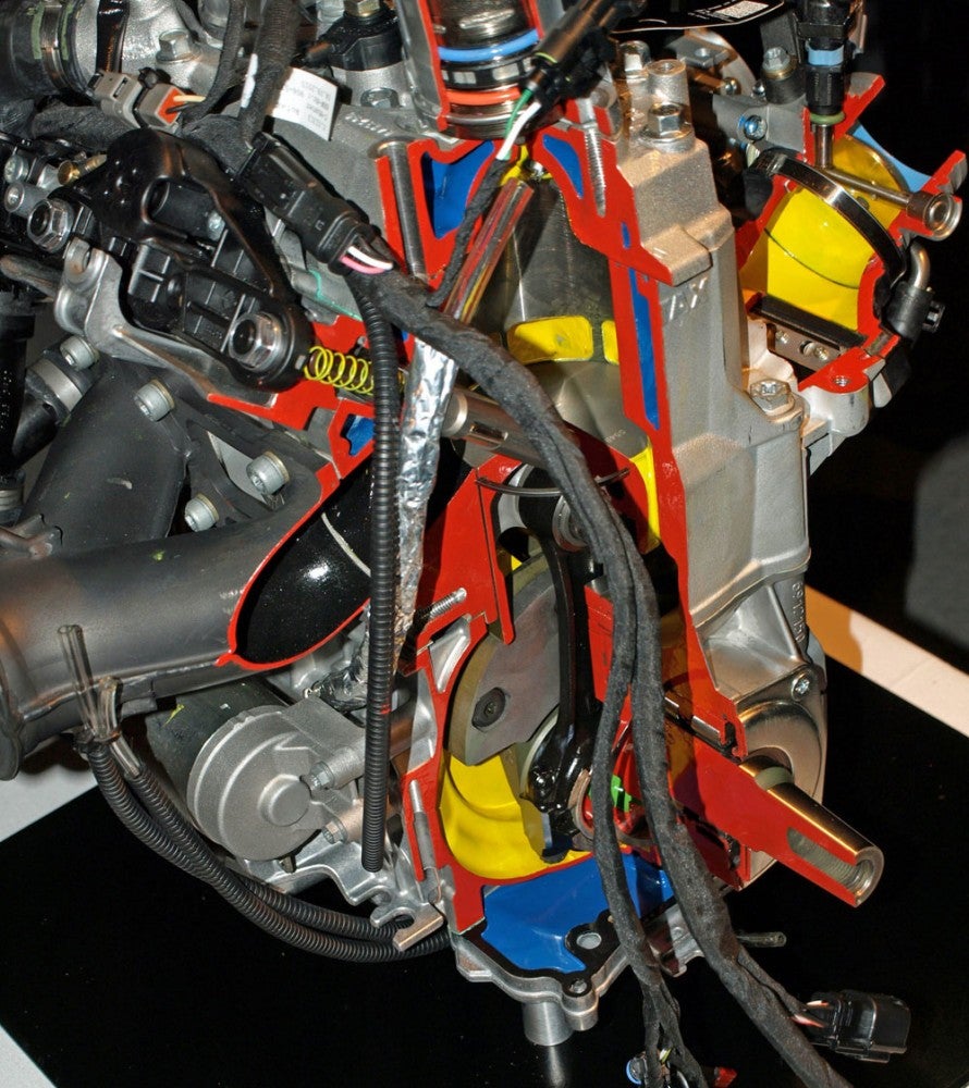

Or like those changes proposed by Rotax / Mercury with their E-TEC technology.
The photos are from http://www.snowmobile.com/manufacturer/ ... -850-e-tec .
They would be better if the photographer had disconnected / put aside the cables.

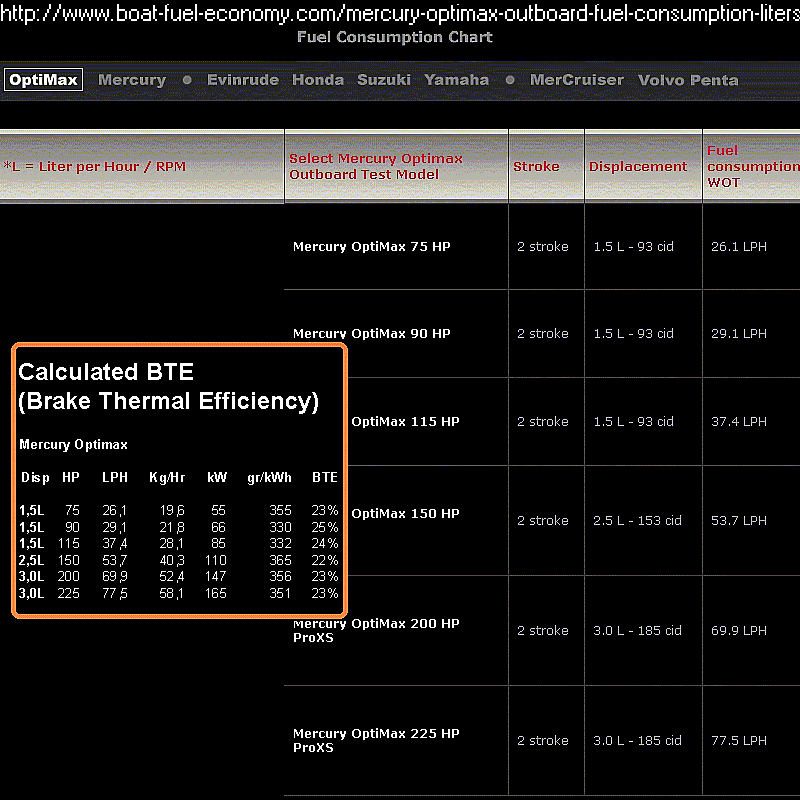

“Mercury uses the Orbital 'Optmax' DI system, whereas BRP/Rotax/Evinrude have the E-TEC DI”
In case the data at http://www.boat-fuel-economy.com/mercur ... ion-liters are true, here is the calculated BTE of the various Mercury Optimax two-stroke engines:
Despite they are using the famous Orbital DI system, they are not good, at least not at full power.
Similarly for the Evinrude E-TEC marine engines:
Take the small Evinrude ETEC with the 50HP. With 17.2L/Hr official fuel consumption (WOT) it gives a BTE of only 23%.
Take the big Evinrude ETEC with the 300HP. With 97.9L/Hr official fuel consumption (WOT) it gives a BTE of only 24%.
Despite the “high-tech” systems they use, the Mercury Optimax, the Evinrude E-TEC (and the Rotax E-TEC) two-strokes are not really good in practice.

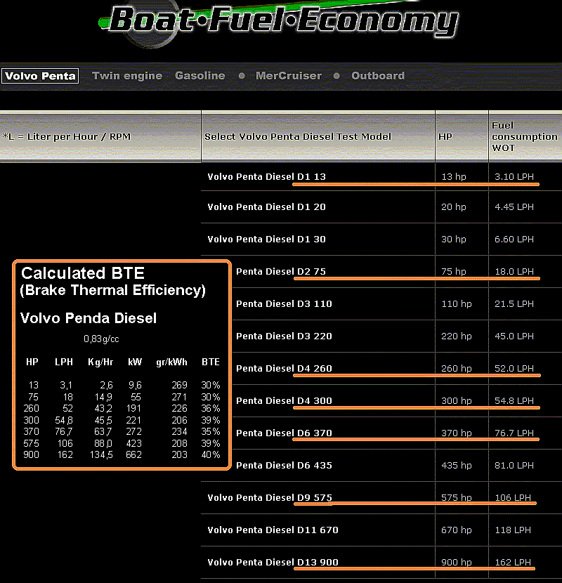

For instance, the 4-stroke MerCruiser 5.0 MPI 305 cid achieves a BTE of 29.5%.
Here is the calculated BTE of some Volvo Penda Diesel four-stroke engines:
The specific density of the Diesel fuel is taken 0.83g/cc.
As the Evinrude E-TEC / Rotax E-TEC / Mercury Optimax (i.e. as the most advanced two-strokes), similarly the Diesels cannot run too lean at peak power.
However they keep a high BTE (near 40%) till their peak power.
