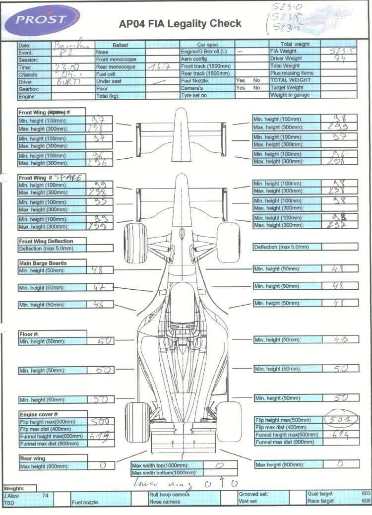

They could do that but FIA examins cars after the race so if Ferrari would change angle they'd be caught. It wouldn't be diffrent from cheating at any other part of the car and being caught means disqualificaton and/or additional sanctions.
http://www.gurneyflap.com/Resources/fiacheck.jpeg
