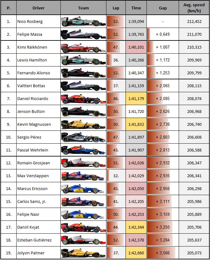

ALO was the fastest on finish line at the Russian GP. Seems that Honda's PU has a good aceleration. I can remember McLaren had good starts in 2015 also. https://twitter.com/hlawiczka/status/726869017831563264
212
Re: Honda Power Unit
namao wrote:ALO was the fastest on finish line at the Russian GP. Seems that Honda's PU has a good aceleration. I can remember McLaren had good starts in 2015 also.
You can't use all the power from the PU on starts, you'll just get wheel spin. It's more about mechanical grip(chassis) and control of the PU power off the line. Then whoever has the most downforce can apply power sooner and at slower speeds(again chassis). Having less power could help you get off the line faster.
