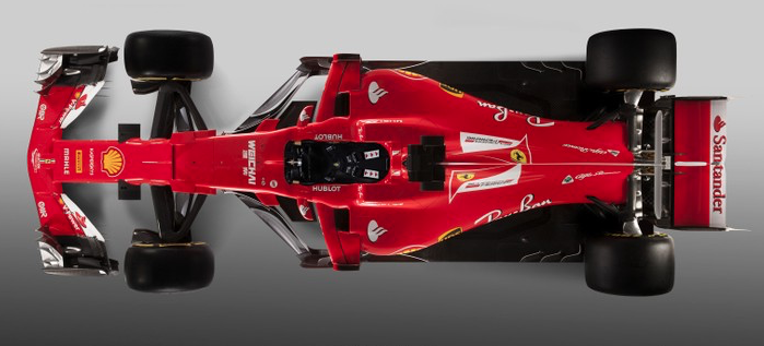

could there be a protest against the Ferrari side pods? (retaliation from RB if Ferrari protest their suspension)
or ar they indisputably within the regs?
F1Krof
94
Joined: 22 Feb 2016, 21:17
Re: Scuderia Ferrari SF70H
FrukostScones wrote:could there be a protest against the Ferrari side pods? (retaliation from RB if Ferrari protest their suspension)
No, because the sidepods fully comply with the rules. Yes, there could be a protest but it would be overturned immediately.
More likely there will be some copying...
Mr.G wrote:
Looks very hard to do. The SF70H has a very complicated cooling infrastructure in there, and the sidepods have been moved backward by a lot. This kind of change would require a new cooling set up and a new chassis. Suspension will probably also have to be changed as it requires a very specific geometry.
And then I'm not even talking about the aerodynamic implications. This is not something anyone is going to copy until next year.
turbof1 wrote:
Mr.G wrote:
Yes I understand, but you can copy to the next season or for bigger changes mid season... But what I was thinking was the idea of overcomming the rule by the flow conditioners in front of real sidepod - you know Ferrari have sidepods in 90° and the rest in some angle defined by rules. That is what I think will be copied by teams and merged with they aero/packaging needs.

The flow conditioners in front of the real sidepod are legal only because Ferrari moved the real sidepod that further back, further then other teams. To change that would be changing the structural part of the sidepods (which are an integral part of the chassis), moving the side crash structures back, and then crash testing the whole deal again.
viewtopic.php?p=680589#p680589
Look at the image. The other 3 cars have their sidepod starting out around the steering wheel. Ferrari's true sidepod starts at the headrests. Again, sidepods entrances are a part of the tub.

Is it me or the actual sidepod openings of the Ferrari are similar to the 2010/2011 Ferrari sidepod design (and 2011-2013 Lotus and 2013 Mclaren) regarding their shape and their aim? (those teams also have pushed the sidepods a bit backward and put a secondary crash structure inside the smaller upper lip) http://i.imgur.com/I5vhFDV.jpg

turbof1 wrote:
Mr.G wrote:
I completely agree. The entire philosophy of the car's aero and internal architecture is designed around those sidepods. No way the teams could copy it and in truth it would be a waste of resources. The amount of man hours it would take to redesign an entire car would probably be better spent trying to make up the ground in other areas. I think we're going to see the most changes around the barge boards, front wings and diffuser on these cars. It's just too big a job to start dramatically redesigning the sidepods.

Yeah, it is very difficult to be replicated. I Just wondering, even newey interested with that sidepod, maybe because he know that will cost a lot of drag but better in managing or splitting bottom and upper airflow, and cannot be done without powerful engine, also very difficult to be improved especially to reduce its drag. Only merc can afford this design, but no way in following Ferrari design.
