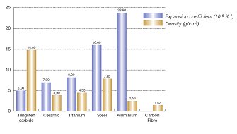

lets go back to the starting point of this discussion:
the claim was: with the engine temperatures anything between ambient and say 150°C
and made mainly from alumimium castings ,the tub made from carbonfibre-aluminium Honeycomb with Carbonfibre Not expanding with temperature there will be a mismatch at the Interface between engine and tub with the bolts providing the clamping force resulting in shearforces due to one structure altering their dimension whereas the other very likely not to grow over temps.
the big difference we see in this application compared to say iron /aluminium is :Iron does in fact grow as well over temp...and the thermal delta between head surface and block surface will be not big ..so the stress is only caused by the different rates of expansion and not over the differtence in temperatures of the two components.To illustrate the big difference between an aluminium /steel cobination and alumium carbonfibre combo:
Now we have had the question of aluminium core in the CF sandwich ...I´d think this is only applicable for the core thickness really.the honeycomb itself is not stiff at all over in plane so it will do what ever the carbonfibre skins will do over temp(e.g.nothing basically).
and the thing with the open U structure of the tub effectively taking up the dimensional changes this maybe true for the grow in width of the engine but not
for the changes to height.So we still got the engine growing in height as it reaches running temps and taking the bolts secured in the tub with it ,causing misalignment.either when cold or when hot..take your choice and hope for the best.
yep
No it wont cause misalignment. You see the square metal surfaces, The engine clamps against those with such a high pressure that the temperature change wont cause any relative motion there. Remember as well that the bolt is basically a cantelever anchored into the tub, so it will prevent engine movement.
The engine will grow at the outer boundaries, but at the bolt holes it will be compressed. We will have stress concentrations at certain points, but this will be on a really small scale.
Even though the cfrp has a lower coefficient than cast iron. It still conforms by the same mathematical relations. So if you were to model a situation both with carbon or cast iron as the tub, the only thing that will change is the expansion coefficient of the tub. No matter how mismatched the materials the results should be similar, just that one may be more extreme.
I did a sim a while back with a cast iron block retaining an aluminum piece by 4 bolts. I exposed the aluminum to 100 degree heat. I didn't post it at the time becuase of the aggression towards FEA. :lol: I intended to use carbon, but i didn't have the physical properties at the time. There was no part failure, just some movement at boundaries. The highest stresses were near the bolt holes.
One more thing:
Though the carbon's expansion coefficient is zero it will still extend. It wont extend because of temperature, but it will see some movement from the engine pushing against it. It wont be a shear stress by it self. It will be a tensile stress, since the bolts are probably staked into the tub.

both materials aluminium and Carbonfibre are very stiff -and are characterissed by a high e-module .
The claim that the expanding aluminium would just carry the carbonfibre with it is contradicting the higher e-module carbonfibre is showing.
On top of that Carbonfibre is very brittle and fails at a elongation of only 0.5%...
so considering our estimated grow or elongation which was around .25% we are not tearing the thing apart in the first heatcycle but the carbonfibre should see considerable stress.Resulting in possible microruptures especially in the bonding areas where the inserts are mounted.
cf orientation could this help in that area,by putting all fibres in right angles towards the elongation direction would reduce the stiffness.but do we even want that?
