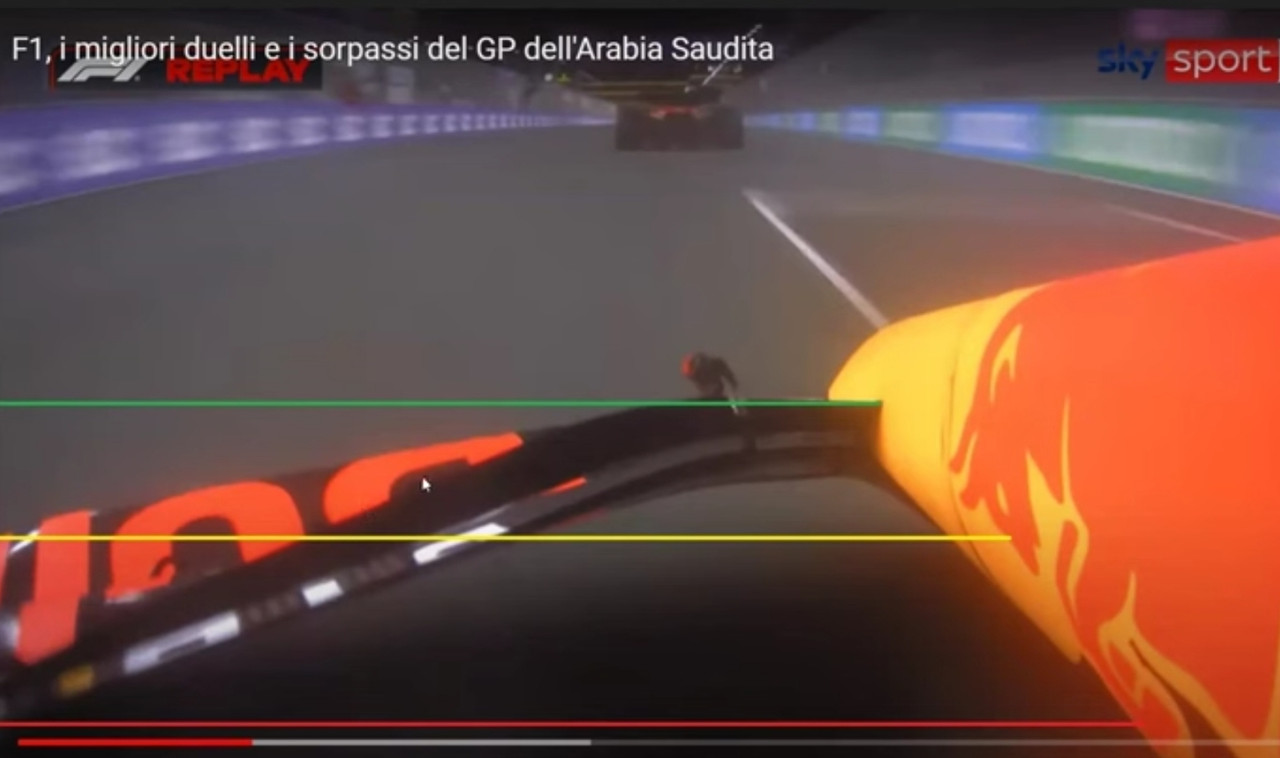

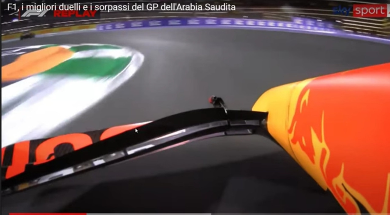

Andi76 wrote:
12 Mar 2024, 08:16
Every year again - the discussion about flexi-wings and TD018 has started because of Red Bull's front wing in Abu Dhbai
https://postimg.cc/c63wCY4k
https://postimg.cc/sGzXvMwb
Thought this might get brought up as a talking point…
Regardless of the rights & wrongs, every team other than RedBull has the flap adjuster on the outside of the FW flap. You can see how much the ‘free’ end of the flap moves on the on-boards (indeed you could see the hinging mechanisms at play last year before the TD was enforced); however, you cannot see what is happening at the outboard end.
On the RB20 the adjuster has been moved to the in-board end of the assembly (a bit of eyeball CFD suggests that this item will have a similar effect to the new Merc FW vortex generator), meaning that although you can see the assembly flex it is impossible to quantify how much.
Downstream airflow is stabilised (the profile in the centre is maintained at all times - got to be good for body flows), downforce & drag are bled-off on the outboard end - probably having a positive effect on outwashing.
However…
As all of the other teams are using the same mechanisms how do they appeal???

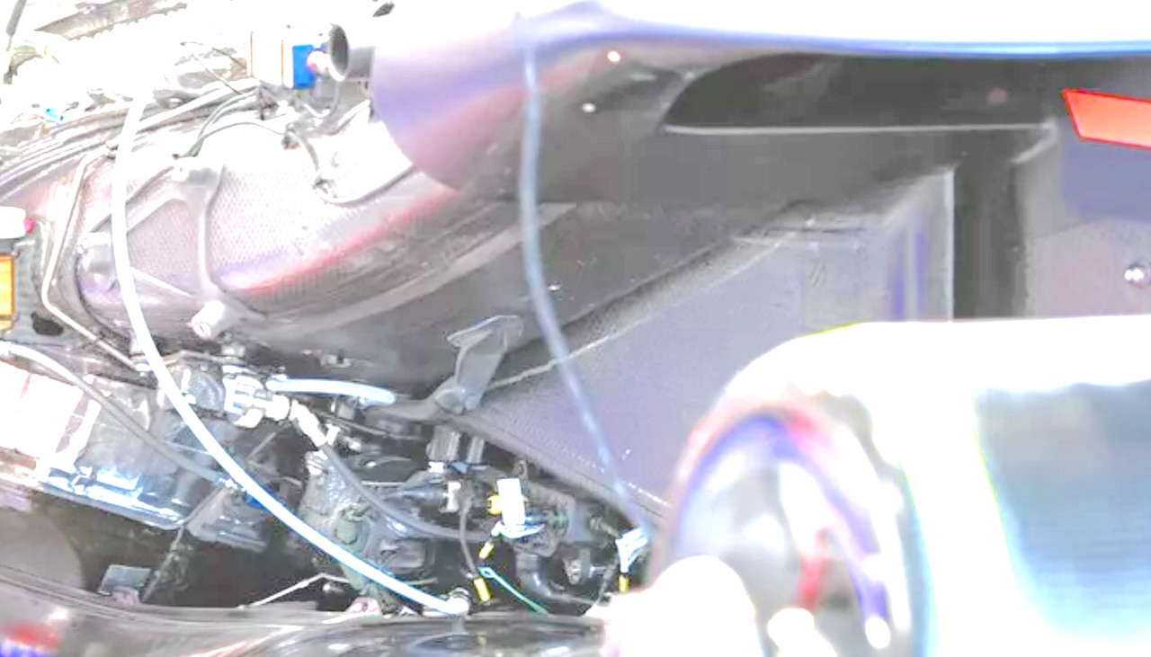

Looks like a different cooling layout where the outlet of the halo inlet fed radiators is not channeled out to the side but merges with the center-line cooler (?)
via NicolasF1i

MtthsMlw wrote:
12 Mar 2024, 15:21
https://pbs.twimg.com/media/GIePqXUWwAA ... &name=orig
via NicolasF1i
Top Saudi, bottom bahrain
TEHNOS
Joined: 03 Nov 2011, 19:02
Re: Red Bull RB20
Seems RBR has accumulated waste amount of knowledge regarding cooling arangements. They are turning around different cooling options like Lego bricks. Unlimited WT cooling testing time well spent.
I wonder if it is just shrinking down the overall cooling until serious drag reduction updates arrive soon?
Such a telented band. :mrgreen: =D>

Andi76 wrote:
12 Mar 2024, 08:16
Who is discussing it? This is on every car.
