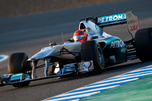

raymondu999 wrote:Mind pointing out the fine tunings?
Sorry couldnt upload before..
Here is a picture of the new (under) and old (up) fw

Good spots.
There looks also to be a new gurney just above the "syntium" logo on the upper element

Forgive me if this has been covered before, but what is the purpose of what looks like the top of a small concave diffuser (circled in red) either side of the mounting struts?

hardingfv32 wrote:Forgive me if this has been covered before, but what is the purpose of what looks like the top of a small concave diffuser (circled in red) either side of the mounting struts?
Brian
Unless I'm missing what you're referring to, aren't those the camera mounts..??

No, these would be the first objects on the top surface of the main element outside the mounting struts.

Do you mean this bit? I have been wondering this myself.
