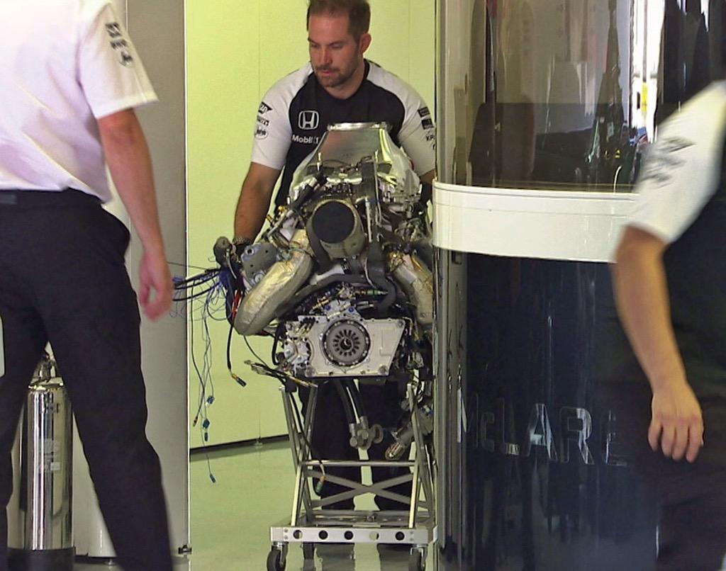

Maybe we can conclude something along these lines:
I'm not sure they give much indication of where the compressor is.
dren
228
Joined: 03 Mar 2010, 14:14
Re: Honda Power Unit
Those pictures really do not show anything new. And yes, those are the charge pipes to and from the intercooler.
