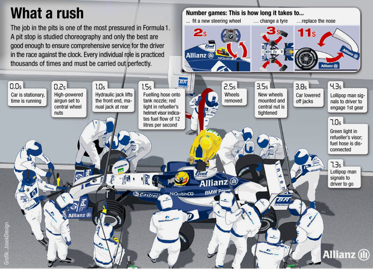

The job in the pits is one of the most pressured in the world of Formula One. Pit stops have become more and more important over the last years. Since overtaking moves are rarer than ever, pit stops have become the prime opportunities to gain places. A pit stop, though, is never as easy as it looks. For seven seconds, if all goes well, the drivers' changes in the race are in the hands of his pit crew.
Pit stop guide
Step 1 The driver enters the pit lane at full speed but brings the speed down to the pit lane speed limit of 80km/h (60km/h in a very tight pit lane, like in Monaco). As he crosses the pit lane line, he engages a pit lane speed limiter that electronically prevents the car from accelerating above the speed limit. Selecting the limiter, the fuel filler flap automatically pops open. The driver has to stop exactly on the marks painted on the pit lane so the mechanics lose no time repositioning themselves. When the car stands still, the driver sets it in neutral and keeps his foot on the brake so that the wheels don't turn as the wheel nuts are spun loose.
Step 2 The car is lifted up onto its jacks as the mechanics remove the wheels and the fuel hose is attached.
Step 3 As the fuel is going in, new wheels are attached and the mechanics raise their arms in the air to show they have finished.
Step 4 As all the four wheels have been changed, the car is lowered to the ground and the last fuel is pumped in. The driver is shown a board (the lollipop) telling him to engage first gear.
Step 5 The fuel hose is detached and the car is ready to go.
Step 6 The driver is waved away by the lollipop man. As the car is leaving the pits, the fuel flap automatically closes if the driver again pushes the speed limiter button.

These six steps may seem easy but need to be executed in only 7 seconds.

Wheel changing crew Each wheel has two to three crew members. One operates the compressed air-driven gun that removes the single, central retaining nut. Then one of the other mechanics removes the old wheel and one fits the new one. The gun man then re-attaches the nut and tightens it to around 500 lb/ft (pounds per foot).
Refueller
The refueller is supported by two other crew members. He has to lift a heavy nozzle over his shoulder and get it into the tank the moment the car arrives. The refueller handles the hose itself and another crew member presses on the 'dead man's handle' which has to be kept down in order to fuel the flow. As soon as the handle is released, the fuel stops flowing.
The rig delivers 12 litres of high-octane fuel a second.
The rig is standardised and provided by the governing body, the FIA, to the teams who are not allowed to modify it in any way. Attached either to the hose or to the refuellers' helmets are indicators showing when the fuel is flowing and when the process is completed. As soon as these indicators tell the refuellers that the car is full-up, they release the latch that holds the nozzle to the filler and then use a second handle to release the nozzle from a connector on the car. Overseeing the whole operation are two crew members, each with a 60-liter fire extinguisher. Larger capacity fire hoses are at hand in the garage. An additional safety feature on the fuel rig are earthing strips that are wired to the refuelling rigs and reduce the chances of static electricity discharging — highly undesirable with all that fuel around.
