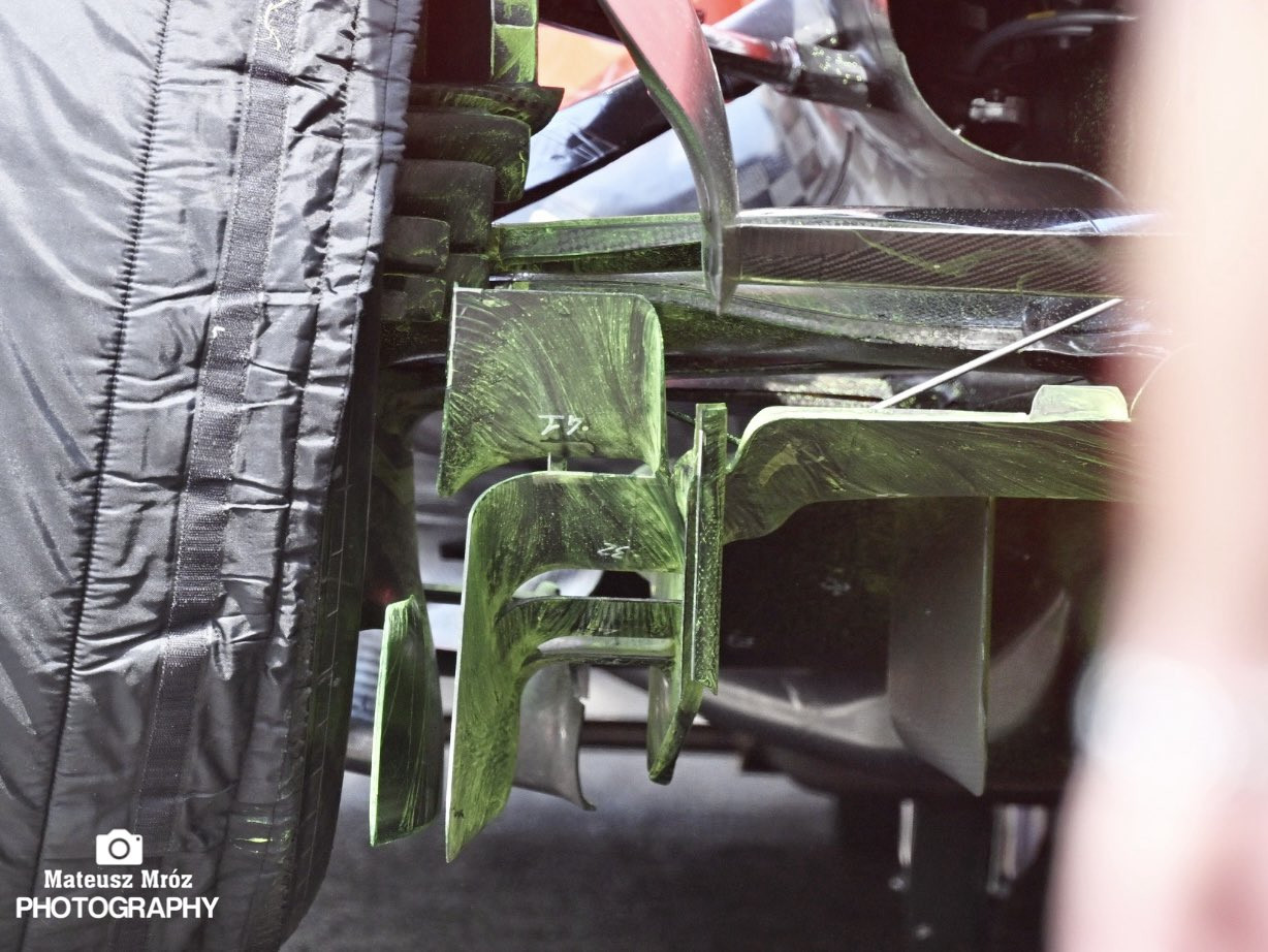

Looks like they've removed the middle winglet and moved the upper one down compared to Silverstone. Must be a low DF spec for higher efficiency.

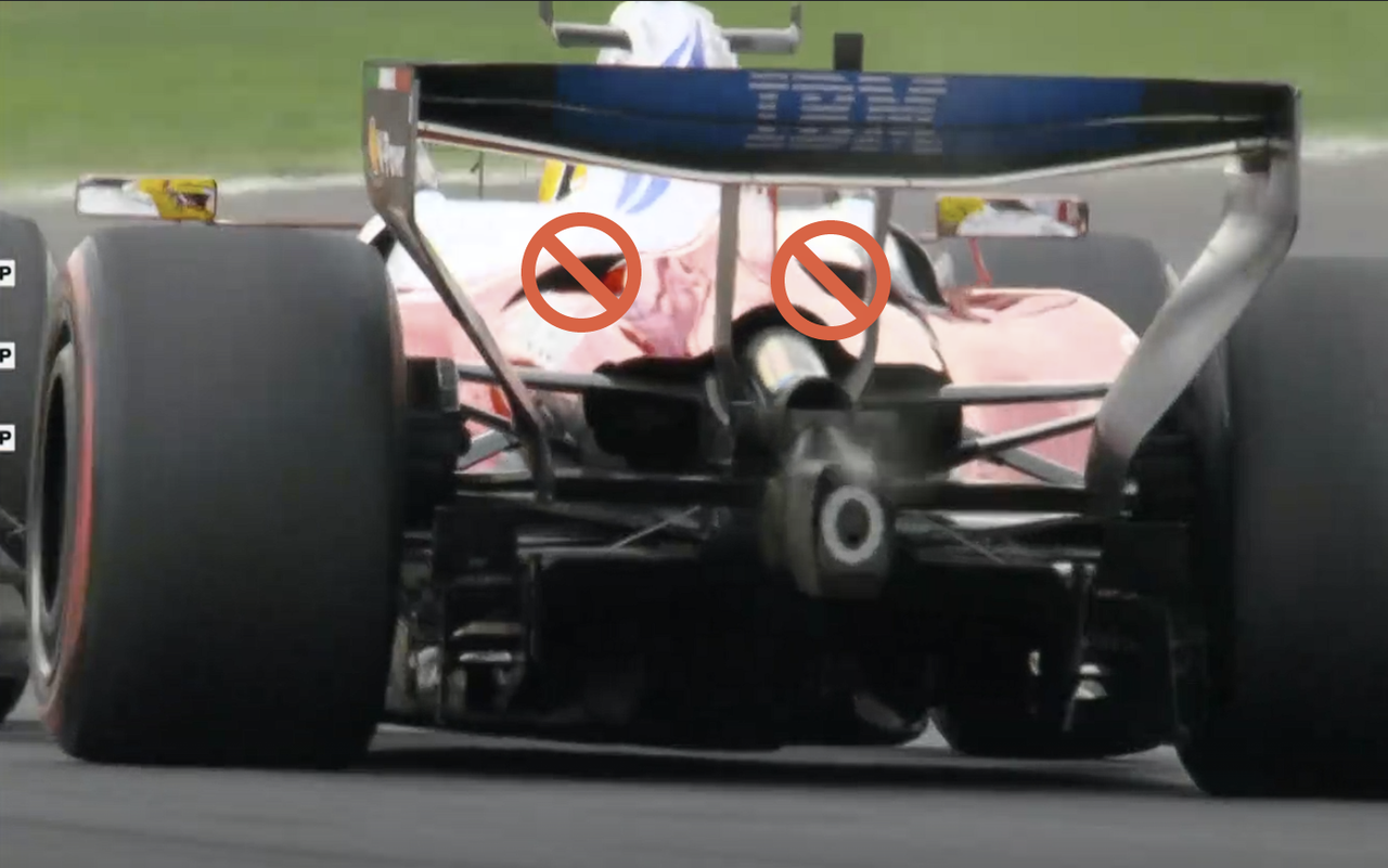

the middle cooling exits were closed for FP3/qualy.
