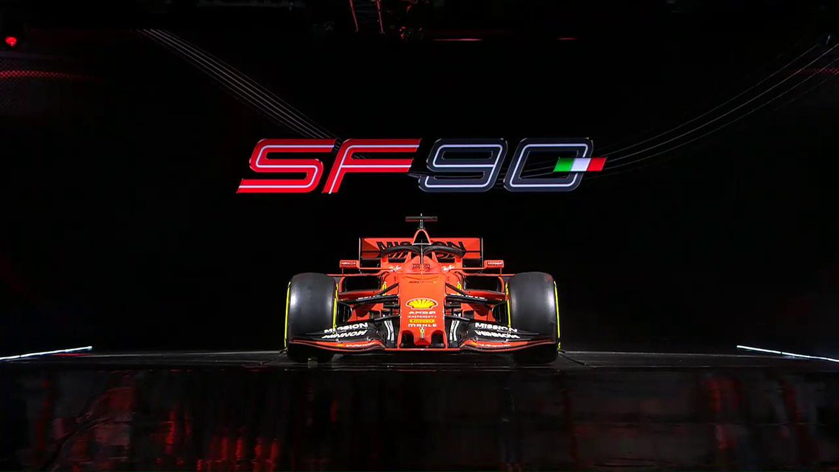

This is the Scuderia Ferrari SF90 offical car thread.
Please discuss ONLY technical items of this car, and refrain from speculation.

Aaand open for business.....

New hole on the nose
Is that a outlet near the "H" of Hublot?

Same philosophy as last years car, I would say with forced changes coming due to the new regulations. The Renders, Studio photos do not show the hole picture and even the presentation was in quite dark/cinema atmosphere so I would say first real indication on Monday @ Barcelona

2 "forks" for opening DRS? Interesting. Also wastegates are on top of exhaust

So, it seems like Ferrari is using a similar FW concept as Sauber. Also all three Ferrari engined cars have the stacked exhaust, let's see if this is of any help.
Then i noticed that the sidepods look rather bulky, but that may just be me.

traditional mirrors
https://pbs.twimg.com/media/DzcG5x9WoAEXwdi.jpg
Hole was there last season too... maybe slightly smaller

Unique airbox and look how big the shark fin is, super tight packaging.

Dunno if it is because of paint but they also have a higher part of bargeboard after restricted zone

2 holes near the upper airintake? what's the function they're bring?
