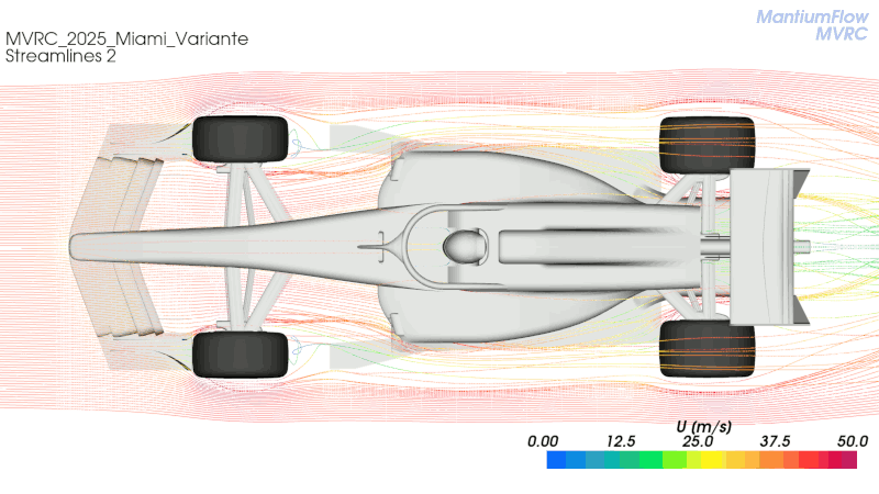

Today, I have some CFD images for you:
https://mantiumchallenge.com/cfd-images ... mvrc-2025/

LVDH wrote:
20 May 2025, 11:55
Thanks for this.
https://mantiumchallenge.com/wp-content ... images.gif
Well if that doesn’t highlight how well JJR is utilising in wash at the rear, nothing will
MVRC - Panthera
LVDH
47
Joined: 31 Mar 2015, 14:23
Re: [MVRC] Mantium Virtual Racecar Challenge 2025 (Grand Prix Cars)
yinlad wrote:
20 May 2025, 12:33
Yepp, his rear wing and diffuser seem to be really happy about this.

LVDH wrote:
20 May 2025, 15:01
yinlad wrote:
20 May 2025, 12:33
I hope mine can be too. I was cursed with a massive separation bubble at the rear of the sidepod which ultimately limited the inwash I was creating. I’m hopeful that I can find some gains by fixing that among some other things for Monaco, I’m sure it won’t take long for others to catch up now.
