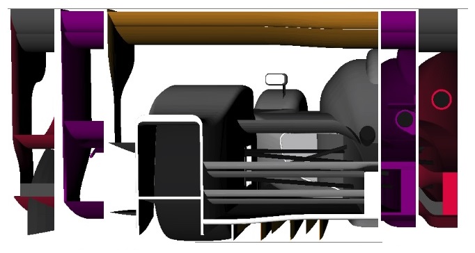

I like the mini wing above the exhaust on the JJR car. He is taking every small bit of downforce he can get. And he seems to be doing something smart in his rear wheel wells. They are always different from the other cars.

Another interesting image:

LVDH wrote:
28 Jan 2019, 12:01
On the negative side... I think it's the first time I've thought the front of JJR's car looks a bit ugly.... :lol:

Re: [MVRC] Mantium Virtual Racecar Challenge 2018
Yeah, but those two nostrils go somewhere...

CAEdevice wrote:
28 Jan 2019, 12:08
https://www.caedevice.net/SERVER/MVRC/2 ... wing_2.jpg
On one side, this comparison worries me: seeing you not using the full Rear Wing volume might mean that Daytona is more an efficiency track than i thought, and my car is outside the range of optimal configuration.
On the other side it might be an indicator that you two did not manage to find enough front downforce, therefore did not need to balance it with a huge Rear Wing.
In either case, i think my car will be the one with the greatest amount of downforce. Let's see...
What i find interesting is also your diffusers' outlets. Their area is much smaller than mine. It looks like you don't care about the final upward kick, and instead you are favoring something else, like vortex management (and longevity).
LVDH wrote:
28 Jan 2019, 16:19
Where?! Where?!?
variante wrote:
28 Jan 2019, 18:34
I think the second option is more probable
I have no idea about the numbers, it is the first time I am so confused
Simply I had no advantages with a larger diffuser outlet

CAEdevice wrote:
28 Jan 2019, 11:53
If the cars were all perfectly balanced and without flow separation, my guess (looking at the rear wing) would be:
1) Variante
2) JJR
3) Pure Power
I had to trim the rear wing and add some diveplanes for getting better CoP as a last minute change. I dont think my car will go further than 4th as usual.
