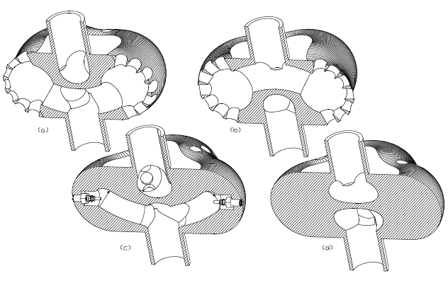

Isn’t it obvious, from the above drawings / animations, the position of the spark plug and the way it can be mounted?
Quote from the PatWankel web page at http://www.pattakon.com/PatWankel.htm :
“The inner body has intake and exhaust ports and passageways, it also has ducts for the installation of the spark plugs and/or injectors, etc.
There is plenty of space enabling the installation of the ignition system (including the generation of the electric current required for the ignition) inside the inner body, near the intake ducts (to avoid overheating).
The spark plug holes on the working surface of the inner body pass over the seals of the chamber at the end of the expansion (i.e. way later than in the Wankel rotary engine) reducing several times the relative leakage”
End of Quote.
The word “pre-chamber” is not mentioned in the above web page because there is no need for pre-combustion chamber.
On the external body there is a cavity / a recession wherein almost all the gas is concentrated at the end of the compression in a way similar to the two-strokes of the last post.
So, the working combustion chamber comprises a “cavity” at its top wherein all the compressed gas is squeezed at the end of the compression:

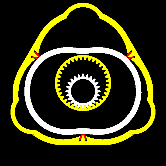

For instance, in the following drawing:
at top-left all the gas previously entered into the one working chamber is concentrated inside the “left” cavity (formed in the outer body).
The inner body has a hole (its end is shown) through which the spark plug “sees” (and actually sweeps; think the case of a model PatWankel engine with a glow plug in the place of the spark plug) the cavity with the compressed gas.
The spark plug cannot extend outside the working surface of the inner body (otherwise there will be collision of the spark plug with the seals).
The end of the spark plug can be, say, 0.5mm from the working surface.
A single spark plug mounted on the one lobe of the inner body can serve all the three combustion chambers.
The hole for the spark plug passes over a seal only at the end of the expansion, i.e. way later than in the Wankel rotary engine, reducing several times the relative leakage
The spark plug is actually located at the “center” of the above “cavity” (say, as in the Evinrude E-TEC G2 in the previous post).
Obviously, multi spark plugs can be used. There is space in the inner body.
In comparison, in the LiquidPiston XMv3 they use three spark plugs which cannot be located centrally.
So, the spark plug hole on the working surface of the inner body is just a hole through which the spark plug communicates with the “combustion cavity” (and not the entrance of a pre-combustion chamber (however, it is obvious how a pre-combustion chamber could be form and function in such designs).

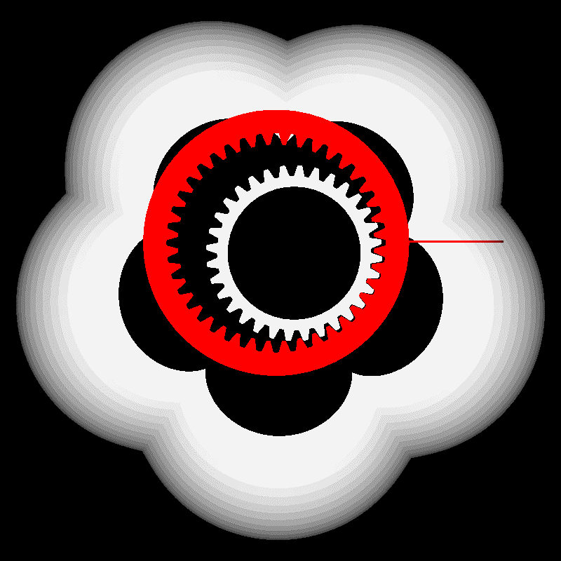

Hello all
Here is the inner body of the five-“cylinder” PatWankel rotary engine and the way to cut it in a lathe:

Regarding the machining of the working surface (the only surface that needs high accuracy) :
On the chock of a lathe it is secured eccentrically a shaft.
The red gearwheel is secured immovable on the lath bed.
The body with its gearwheel (white) is rotatably mounted on the shaft.
As the chock rotates, the body to be machined performs a combined motion (it spins about the shaft and it orbits together with the shaft).
Given the shape of the seals to be used (the simplest form? the circular), the cutting tool has to follow a specific “path” (like half circle, for instance) in order to create / form the working surface on the part (the working surface is whereon the seals will abut and slide during operation; the seals are mounted in grooves made on the outer body).
In case of seals having simple form, even a conventional (not CNC) lathe can be used.
Similarly for the honing / polishing.
The machining of the outer body can be done in a similar way with the inner body.
Each half of the casing is located on the eccentric shaft
The red part shows the path of the cutting tool.
For each recess / chamber in the casing, the “white” gearwheel” is properly secured on the half casing (at an eccentricity equal to one quarter of the pitch circle diameter of the white gearwheel):
In the animation it is shown only a part on one rotation. It is supposed the rotation of the lathe chock is continues.
During the first six slides of the animation, the cutting tool is in the air (it cuts nothing).
For the following 19 slides the cutting tool removes material from the one chamber, doing nothing for the rest four chambers.
For the last five slides the cutting tool is in the air again (it cuts nothing).
With the previous machining work, the clearance between the inner body and the outer body can be quite small at operation (like, say, 0.2mm), which means almost all the gas at the end of the compression is concentrated in the “combustion cavity” formed at the “top” of each working chamber, on the outer body.
After machining all five chambers in each half of the casing, the grooves for the seals are machined on a CNC mill. For the grooves the significant dimension is the width (the distance between the two flanks).
If the previous are confusing, please let me know to further explain.

Hello Muniix
You write:
“Yes but your sealing array is totally different, experiences totally different forces and is three dimensional whereas the RX-8 is just apex and side seals.
The forces that need to be dealt with are the thrust forces the seals see from combustion pressure, one needs to dynamically adapt to these forces that are trying to seperate the seal from the surface they are abuting to. As pressure rises it will force this seal to collapse, one needs to compensate for this force, while not providing excessive force as to create to much friction whan not needed. This is typically done with gas ports, that allow the cylinder pressure to get behind the seals, this acts like a capacitor, it also has to deal with the sliding friction of the working surface the seals are sliding against, so the pressure between the seal and its slot surfaces needs to be carefully balanced to avoid the seal being forced against one slot face and creating too much friction with that face. A spring behind the seal needs to provide just enough tension to support the minimun sealing force and cover for the period before the gas force is used to assist the sealing force.”
It seems you didn’t yet got the mechanism according which the seals in the PatWankel work.
Start with the top ring in the piston of a reciprocating piston engine.
It is made to have a slight preloading to keep its external (or better: working) surface in touch with the cylinder liner.
The pressure in the combustion chamber of the reciprocating engine arrives into the groove of the seal and pushes it towards the cylinder liner and towards the bottom of its groove.
What is so important with it?
The pressure ring abuts heavily onto the cylinder liner only during the high pressure period of the cycle, achieving the necessary sealing at low friction loss.
Think of a bicycle pump, that with the leather seal. During the compression the leather seal is pushed towards the cylinder wall and achieves the required sealing. During the suction of fresh air, the seal adds no friction.
The difference of the PatWankel seals as compared to the reciprocating piston rings is that, depending on the version, the “working “ surface is either the “external surface” of the seal, or the “inner surface” of the seal (version with the working surface on the inner body) like:
wherein each seal and each groove serve one only working chamber, the working surface (whereon the seals abut and slide) is the external surface of the inner body:
Here is the inner body alone, with the three seals on it:
In the following drawing the two, of the three, seals have been removed.
The working chamber at left is at its TDC with its seal surrounding it and sealing it.
The inner body is like a "piston" pushed deaply into the working chamber (an unconventional piston that needs neither a connecting rod, nor a crankshaft).
As the inner and outer bodies (which comprise the engine) rotate, the "piston" (i.e. the inner body), remaining permanently in contact with the seals, is pushed outwards from the chamber and the volume increases (expansion).
The “sealing” principle is the same with the reciprocating piston engines: the pressure in the working chamber is also the pressure inside the groove of the seal. This pressure, during the high pressure period of the cycle, forces the seal towards the “working surface” (and towards the “bottom” of the groove, just like in the reciprocating engines) and seals the working chamber.
Each working chamber has its own / exclusive seal and its own / discrete groove wherein the seal is mounted.
The left side of the inner body shown in the drawing is at the TDC.
The left seal surrounds the one working chamber and abuts on the working surface on the inner body, just like a piston ring abuts on the cylinder liner.
The pressure at the left side of the groove wherein the left seal is inside (not shown in the drawing) equals to the pressure into the “left” working chamber. This pressure, just like in the reciprocating piston engines, presses the seal to abut on the inner body and onto the right side (i.e. the bottom) of its groove.
At operation the "piston" (i.e. the inner body), remaining permanently in contact with the seal, is pushed outwards from the chamber and the volume increases, then the "piston" is pushed inwards and the volume decreases, and so on:
Every point of the inner periphery of the seal remains permanently in contact with the external surface of the inner body
Now, look again at the pie-plot of ASME and think the reduction of the gas leakage in a rotary engine (and the friction reduction, and the wear reduction) in case the “RX-8 apex and side seals (you forgot the four corner (or button) seals that participate in the sealing of each working chamber of the Wankel) and the “cylindrical” design of the Wankel with the infinite curvature at the corners, are replaced by the 3D working surface and the 3D seals of the PatWankel.

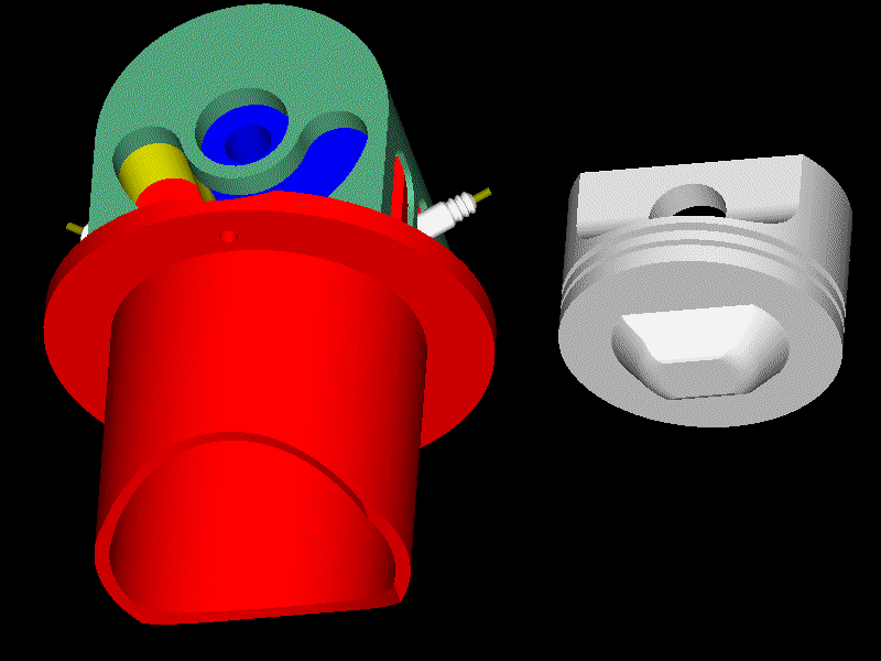

This animation:
shows a way (there are others) to have, in a PatRoVa reciprocating engine, as high compression ratio as you want, without compromising with the ports size: an extension on the piston crown occupies, when the piston is at the TDC, a part of the cavity increasing the compression ratio.
The size of the ports can be as big as you like.
The free flow of the gas is not affected.
The windows can be substantially bigger than Bishop's (the same cylinder head can be used on smaller and smaller capacity cylinders).
The mechanical friction from the PatRoVa cylinder head is negligible.
The mechanical friction related with the Bishop rotary valve is comparable with the mechanical friction related with the piston: the Bishop rotary valve uses a set of seals moving at a constant speed, which is comparable to the mean piston speed.
During the combustion the piston rings move slowly, while the Bishop rotary valve seals move many times faster.
Friction is added also by the needle roller bearings of the Bishop rotary valve (this friction is comparable to the friction loss on the crankshaft bearings: their angular velocity is half, however their diameter is big, and as “needle roller bearing” they are not too efficient).
The mechanical power consumed as friction inside the Bishop cylinder head is added to the power output of the PatRoVa.
If you have a dyno of the Bishop CRF450 (the power, or the torque, along the complete rev range), please publish it.
It would be a useful reference.

I note that it also has two plugs, an attempt to show them to be an advantage which is contrary to your comments when someone else does it. Having two plugs in such a small area will have no significant effect except consume more power, add cost, size and weight
The modification also will making the design worse off the more you try to increase the port size.
Having two air flows flowing into one another does not = "free flowing", fluid flow is dictated by pressure and if one flow is increasing the pressure on the other side of the window then the flow will NOT be free flowing. It will be chocking.
Each flow negatively effects the others flow through the opposing window, and increases the pumping losses. This is simple fluid flow mechanics.
is the same as
" A bigger and bigger head can be used on the same engine."
One wants to decrease the size and mass of engines as much as possible, heard of "light weighting" and "down sizing" .
That is one of the many advantages of the bishop rotary valve, its small size and weight, high flow co-efficiency, using a single flow stream straight down the centre of the cylinder, creating its unique 'dual cross tumble flow' turbulence enhancement that halves the effective bore to stroke ratio that takes no energy from the flow energy.
Here is why "The bishop windows can be substantially bigger than the PatRoVa's and flow far greater volumes
In the CRF450 instance with a bore of 96mm the Bishop can provide a window that flows with much higher coefficient of 88 x 40, With the PatRoVa its windows sizes are constrained by the size of combustion chamber sides, which are directly related to the compression volume, which couldn't possibly match the conservative 44 x 40 mm each side, let alone increased by the amount needed to correct for its lower flow coefficient when the approximate chamber size is 30 x 30 x 30 mm. Changing the geometry has to take into account that the closer the opposing windows are the higher the pressure will be on the inside of the compression volume chamber slowing the flow.
While the bishop valve can be tuned for maximum flow inertia and for maximum use of pressure waves, these alone provide huge advantages at high engine speed taking volumetric efficiency far past 100% that the PatRoVa flow mechansim can't match, the only thing pulling the air molecules into the chamber would be a hugely lower in cylinder pressure, enough to overcome flow velocity and inertia.
All the sealing issues are solved on the bishop, is may have taken over 10 years, but the result was a very low crevice volumes, your PatRoVa has no sealing so gas can leak into the valve area creating a potentially infinite crevice volume, that will effect the combustion efficiency of each cycle.

The 2D Sealing Grid and the 2D Design of the Wankel was tried for half a century, several billions were invested and lost on it, several automakers bankrupted because of it, and now it is phased out.
The Wankel RX8 is worth for one thing: it confirms that a rotary engine has strong advantages over the reciprocating engines. The point is to “correct” its serious “gas leakage” and “inefficient combustion” issues.
As you correctly wrote, there are infinite different angles in the PatWankel. What you didn’t write is that there is not one point of discontinuity, there is not one infinite curvature, everything is smooth.
If you see the stereoscopic animation the relative with the machining of the working surface, you will see how easily and cheaply these “infinitely different angles” are created with a conventional lathe.
Talking about the Wankel, it is worth mentioning one of the worst problems the engineers of NSU and Mazda experienced several decades ago:
Confused?
No it is not the speed bumps on the roads.
It is the “speed bump” on the apex real “road”, i.e. on the casing:
Look at the “speed bump” at lower and top side of the casing and at the “reverse” centrifugal force the apex seal experiences each time it passes from the area between the two spark plugs (or from the anti-diametrically from the spark plugs area).
Did you ever pass over a “speed bump” with, say, 50mph (80Km/h)?
Did the car take off the road?
The Wankel RX-8 requires strong springs under the apex seals, otherwise each apex seal will take off the epitrochoid twice per revolution around the casing.
Think of the difference in the PatWankel wherein the inner body rotates at constant speed about a fixed axis and the outer body rotates at constant speed about is own fixed axis, which means constant amplitude of the centrifugal acceleration. There are no "speed bumps" at all. The seals and the working surface have a, by far, easier life (reliability)
So, focus on the substantial / structural / geometrical problems of the rotary engine design and leave aside the tuning and the acoustic waves.

The PatRoVa rotary valve solves a fundamental problem of the rotary valves.
Which?
Read how the “Rotary Vale history” at http://www.douglas-self.com/MUSEUM/POWE ... alveIC.htm starts.
As for its flow capacity of the PatRoVa rotary valve relative to the Bishop rotary valve (wherein the increase of the rotary valve periphery and the decrease of the piston stroke results in higher speeds of the rotary valve seals than the piston ring seals), as explained in many posts the PatRoVa can utilize as big ports as you like.
How big?
So big, to allow the complete Bishop rotary valve to pass through them.
So, if the target is the peak power and nothing else, the PatRoVa can make more than the Bishop.

http://www.pattakon.com/PatRoVa/PatRoVa_Panigale.jpg
Above, say, 5,000rpm the overall gas leakage from the “dry” PatRoVa rotary valve is several times less than the leakage in a “decent” Wankel RX-8 operating at low-medium revs as above.
At lower revs, say below 2,000rpm (wherein a Panigale will never run, especially at full load), the leakage from the dry PatRoVa rotary valve is still less than the leakage in the RX-8 at 2,000rpm.
The most significant point where leakage happens is during the compression and power strokes, where the pressure is high, not during the periods of low cylinder pressures!! Showing the exhaust at fully open doesn't show anything meaningfull information on its sealing.
only after solving the fundamental (geometrical, structural, reliability etc) problems of a mechanism, only then it is worth to focus on the details, on the optimization of the breathing, on the twin-spark advantages, etc, etc.

Quote from http://www.pattakon.com/pattakonPatWankel.htm
In the following LiquidPiston rotary engine (or alternatively: in the following section of a PatWankel wherein the working surface is in the inner body and wherein the outer body is immovable) :
they are required two eccentric-shaft-rotations for three combustions (one per working chamber).
The synchronizing gearwheels are heavily loaded during each combustion. This causes wear, noise, friction, "play" of the rotor, need for bigger gaps (and so more gas leakage) between the side seals and the peak seals, need for better lubrication of the gearwheels, etc.
Every time the rotor passes from a combustion TDC (it happens 1.5 times per eccentric shaft rotation), the load on the teeth of the inner gearwheel changes direction; the inevitable backlash is a problem (impact loads, noise, wear etc)
The bearing of the rotor "runs" at 50% higher r.p.m than the eccentric shaft.
The force on the rotor bearing is substantially heavier than the force the high pressure gas applies onto the rotor during the compression / combustion / expansion. The "super-over-square" design causes a heavy force onto the rotor, and an even heavier force onto the fast revving rotor bearing.
There is an extra load on the rotor bearing (also in a continues basis, because every combustion causes this loading) by a strong pair-of-forces caused by the side location of the heavily-loaded synchronizing gearwheels. Due to this pair-of-forces, the side-walls of the rotor stop being exactly parallel to the side-walls of the casing: the seals suffer and the gas leakage increases.”
In comparison, the following PatWankel:
they are required three rotations of the power shaft (which is secured on the inner body) for three combustions (one per working chamber).
As in the Wankel, the synchronizing gearwheels are not loaded by the combustion.
End of Quote
