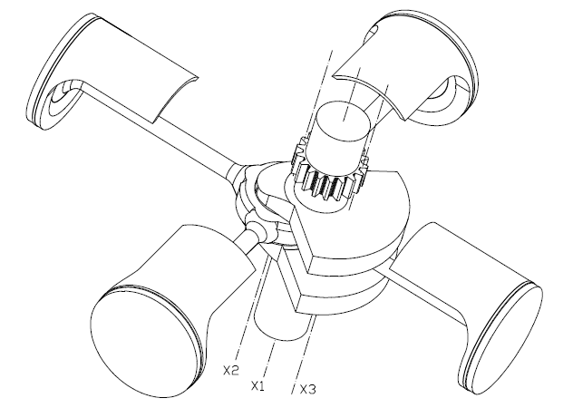

Hello all.
Here is one more unconventional 2-stroke engine:
It is a PatRon Harmonically Reciprocating-Piston Rotary-Engine.
It comprises a crankshaft, a piston rotatably supported on a crankpin of the crankshaft, and a rotating cylinder wherein the piston reciprocates sealing one side of a combustion chamber.
For a complete reciprocation of the piston inside the cylinder they are required two rotations of the crankshaft.
Without external balance shafts, the balancing of the inertia force, moment and torque is perfect (even for the single cylinder).
A synchronizing gearing keeps the cylinder rotating at the same direction with the crankshaft and at half angular speed than the crankshaft; the high pressure gas in the combustion chamber does not load the synchronizing gearing.
Not only the power passes directly to the load and the synchronizing gearing remains unloaded but, additionally, the cylinder liner remains rid of thrust loads. Think how.
The stroke S of the piston along the cylinder equals to four times the distance between the (fixed) rotation axis of the crankshaft and the (fixed) rotation axis of the cylinder.
The relation between the displacement D of the piston along its cylinder and the rotation angle f of the crankshaft is like:
D=(S/2)*sin(f/2)
which is a pure sinusoidal (or harmonic) motion.
With the PatRon:
* the power passes directly to the load (more directly than in the conventional reciprocating piston engines: there is no connecting rod (the piston is rotatably mounted directly on the crankpin), there are no thrust loads on the cylinder liner),
* the synchronizing gearing remains unloaded by the high gas pressures during the compression - combustion – expansion,
* the two halves of the "immovable" casing (one per side of the spinning cylinder) are easily coupled / bridged forming a space wherein the cylinder spins safely,
* only one crankshaft is required (and only a set of balance webs secured on the crankshaft for the complete balancing of the engine),
* there are no high speed bearings loaded by heavy inertia loads,
* in case of air-cooling the rotation of the cylinder simplifies things (the cylinder is also the fan),
* if desired, the power can be delivered by the rotating cylinder (which spins at half crankshaft speed),
* it is for single acting, for double acting pistons, even for “multi-acting” single-piece pistons,
* it is for two-stroke and four-stroke engines, etc
For more: http://www.pattakon.com/pattakonPatRon.htm
In a few words:
The PatRon brings the good sealing and the small surface to volume ratio of the reciprocating piston engines in the rotary engines, without introducing significant side effects.
Thoughts?
Objections?

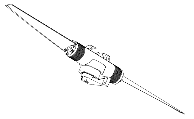

Hello Tommy Cookers.
I had to explain, in another forum, the differences of the PatRon rotary from the Gnome and Rhone rotary engine.
Here are some of them:
In the PatRon the center of the crankpin moves along the cylinder axis, eliminating the thrust forces between the piston skirt and the cylinder liner.
In the Rhone rotary engine (and in the conventional reciprocating engines) the center of the crankpin leaves, at the middle stroke, the cylinder axis for a distance equal to the crankpin throw, resulting in heavy thrust loads which generate friction and require (in order to avoid metal to metal contact) a thick oil film between the piston skirt and the cylinder liner whereon the piston skirt slides.
So, the one arrangement saves mechanical power, keeps the cylinder liner cooler, it requires less lubricant, the piston needs not a piston skirt (lighter piston), the connecting rod is eliminated, etc.
Regarding the connecting rod and its elimination:
In the Honda Civic VTEC 1600cc, used as the host for the pattakon VVA-roller, more at http://www.pattakon.com/pattakonRoller.htm , the piston weighs 300gr, the wrist pin weighs 100gr and the connecting rod weighs 600gr.
Take a pair of pistons with their connecting rods and wrist pins. It weighs 2Kg. It comprises two big end bearings, two small end bearings and four piston skirts (where most of the friction loss happens).
In comparison, a double acting PatRon piston (which serves two combustion chambers) weighs less than 0.5Kg and comprises just one rotating bearing and no “thrust bearings”.
As the connecting rod of the Rhone rotates around the eccentric pin holding the piston at its small end, the inertia force loading its big-end bearing is huge at high revs (think of the eccentricity of the center of gravity of the set: piston – wrist pin – connecting rod).
As the double acting piston rotates about the crankpin of the PatRon, its center of gravity remains permanently on the center of the crankpin and the centrifugal force is smaller. With the center of gravity of the double acting piston permanently on the center of the crankpin, a set of two balance webs secured on the crankshaft counterbalances completely the inertia force of the piston and the “vibration free quality” of the engine is perfect.
In comparison, the connecting rods between the piston and the crankpin of the Rhone (and of the rest conventional reciprocating piston engines) spoils the motion of the piston / wrist pin / upper side of connecting rod. Instead of being pure sinusoidal, it comprises a significant second order which makes the dwell of the piston at the TDC short and the dwell of the piston at the BDC long. It also makes bad the balancing of the engine. For instance, a 9-cylinder Rhone is by far worse in free inertia forces than a single cylinder PatRon (the same is true for the other non-rotary Radial engines, read at http://www.pattakon.com/pattakonPatAT.htm for more).
Regarding the gyroscopic rigidity:
Please look at this drawing:
and think again about “the increase in rotating mass”, about the aerodynamic losses and about the “gyroscopic effect problems”.
What I see is a thin lightweight (because, among others, it is rid of bending loads) aluminum cylinder comprising the central part of the propeller.
In case you want to get rid of gyroscopic rigidity, just drive (by means of a reduction gearing) the propeller to rotate at opposite direction than the crankshaft – cylinder. With the proper selection of the reduction ratio and of the momentum of inertia of the parts (cylinder, crankshaft, propeller) you can achieve zero gyroscopic rigidity
On the other hand, and because the PatRon is perfectly balanced even with one only combustion chamber (single cylinder), you can keep the propeller on the cylinder and put another counter-rotating single cylinder PatRon to drive another propeller (total gyroscopic rigidity: zero).
Thanks

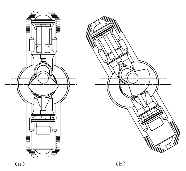

Hello all.
Here is a more “unconventional” PatRon for small airplanes, ultralights etc.:
It is an over-square direct injection Diesel with plenty of piston skirts.
With 120mm bore and 60mm stroke (about as over-square as the Ducati Panigale 1299) it gives a 2-Stroke capacity of 1,350cc.
The maximum dimension of the spinning cylinder is 1ft, i.e. the distance from the top of the one cylinder head to the top of the other cylinder head is only 305mm.
The scavenging is quite strange:
At some angle of the cylinder the piston opens the “leading” port and the pressure of the gas in the cylinder drops sharply.
Several (like 10 or 15) degrees later the piston opens the trailing port, too. The exhaust happens through both ports. Gradually the leading port becomes the intake port with the trailing port being the exhaust port:
The motion of the cylinder in the ambient air pushes air to enter from the leading port to scavenge the cylinder and then to exit from the trailing port.
After the BDC the pistons moves “upwards”; initially it closes the trailing port; the air entering the cylinder from the leading port continues to enter (due to inertia) until the piston closes the leading port, too.
The gas in the cylinder is compressed. Near the TDC diesel fuel is injected into the bowl at the center of the crown of the piston.
After the TDC it follows the expansion.
After the middle stroke the piston opens the leading port (it serves as exhaust port and as intake port) and so on.
I.e. it uses neither crankcase scavenging, nor some external scavenge pump.
If it works, it makes an extremely compact, simple and lightweight Diesel, which is also perfectly balanced, which also provides some 15% longer piston dwell at the TDC as compared to the conventional Diesels (the PatRon running at 5,000 rpm gives to the combustion as much time as a conventional Diesel running at 4,500rpm), and which eliminates the load between the piston skirts and the cylinder liner (the skirts are there only to seal the crankcase).
At 5,000rpm of the cylinder (i.e. at 10,000rpm of the crankshaft) it could make some 200bhp (i.e. as much as the Ducati Panigale 1299) because it is a 2-stroke.
As for its weight, 1/4 of the Panigale 1299 engine is reasonable.
As for its Brake Thermal Efficiency, it has all the characteristics for a top BTE.
This animation is explanatory:
(the same animation at slow motion is at http://www.pattakon.com/PatRon/PatRon_Model_2_Slow.gif )
Regarding the unconventional scavenging, it resembles to the way the Gnome and Rhone rotary engines (those with the ports on the cylinder liner) were running:
(more details at http://thevintageaviator.co.nz/projects ... e/historyv )
They were using the "exhaust" valve of a cylinder unconventionally: initially it was acting as an exhaust valve (during the last half of the expansion cycle and during the exhaust cycle), later (during the intake / admission cycle) it was acting as an intake valve allowing fresh "unfiltered" air to fill the cylinder; at the end of the inlet cycle rich air/fuel mixture was entering into the cylinder through the ports on the cylinder liner.
This version shows how compact the PatRon can be.
For a 1350cc 2-stroke double-acting-piston PatRon the external diameter of the rotating cylinder/cylinder head is only 1ft (305mm)
Applying the similarity (1350/50=27 and the cubic root of 27 is 3), for a 50cc version the external diameter drops to 100mm. Think of a 50cc 2-stroke 2-“cylinder”engine for a chainsaw or for a model airplane having such a size.
Thanks
Manolis Pattakos

Yesterday, in another forum a guy (CheapRacer) published this drawing :
and wrote:
“at BDC the exhaust helps drive it 'round while the open intake mouth gets self-supercharged!”
The combustion chamber is like a long room (say, a corridor) having a big window towards the north and another big window towards the south.
Outside the room there is a strong wind coming from the north (this is what the rotation of the cylinder causes).
At the end of the expansion the north window opens.
The high pressure in the room pushes a big part of the “gas” to exit from the north window and the pressure to drop sharply.
A little later the south window opens allowing gas to exit from that window too.
Due to the north wind, the flow from the north window gradually weakens, stops and reverses its direction, while the flow from the south window strengthens.
With both windows wide open (BDC), the strong north wind enters from the north window, scavenges the room (and cools down the walls, the ceiling and the floor of the room from within) and exits from the south window.
Later the south window closes, with the north window still open.
The north wind continues to enter into the room from the north window (due to inertia / ram effect) overfilling the room with air (a kind of asymmetrical port timing: the exhaust closes before the transfer).
Finally the north window of the room closes trapping the air entered, and the compression starts.
Thanks
Manolis Pattakos

Hello
For the PatRon of the animation (60mm stroke, 120mm bore, 300mm external “diameter”) the eccentricity of the ports from the center of rotation of the cylinder is about 115mm (0.115m).
At 5,000rpm of the cylinder (10,000rpm of the crankshaft) the speed of the leading port is:
0.115m * 2 * pi * 5,000 rpm / 60sec/min = 60m/sec = 215Km/h = 135mph
If this engine, mounted transversely, is powering a motorcycle, then at 185Km/h the leading port sees the air coming with 400Km/h. This could give a 10%, more or less, overcharging (RAM air).

By the way, a single-piece cross-piston rotatably mounted on a single crankpin
can serve two independent cylinders arranged at a cross.
The crankshaft spins about the X1 axis, the one cylinder spins about the X2 axis, the other cylinder spins about the X3 axis.
The engine is even firing.
Thanks
Manolis Pattakos
J.A.W.
J.A.W.
109
Joined: 01 Sep 2014, 05:10
Location: Altair IV.
Thanks Manolis, this drawing may explain some, except the use of the flywheels as integral 3D rotary valves.
