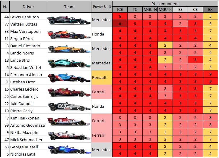

It should be noted the incredible reliability of the hybrid component of the Mercedes engines. Hamilton finished the season with 3 MGU-H and MGU-K, Ricciardo and Stroll with 2 MGU-K.
Spoutnik
Spoutnik
Joined: 03 Feb 2015, 19:02
Re: Mercedes Power Unit Hardware & Software
_cerber1 wrote:
17 Dec 2021, 08:56
https://pbs.twimg.com/media/FGez0AjX0AI ... me=900x900
What's the point of keeping on the 2nd MGU-K with a lot of mileage instead of using a "free" 3rd ?

Spoutnik wrote:
17 Dec 2021, 10:38
_cerber1 wrote:
17 Dec 2021, 08:56
Probably the new K has to be fitted at the factory, as it is a precision job. the ICE TC K & H are shipped together as one assembly. So the built the 3rd and 4th assembly recycling the old K of the 1st and 2nd ICE.
