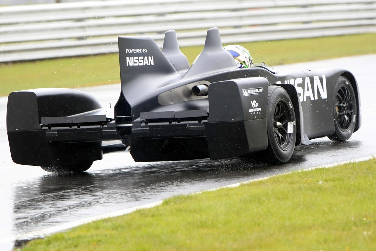

vorticism wrote:
07 Jul 2023, 00:42
They could go heavy on rear weight bias (although the published regs afaik make no mention of this). 70:30. 80:20?
http://1.bp.blogspot.com/-KtdCQKGXUWs/V ... 2A7560.jpg
https://www.carscoops.com/wp-content/up ... 25255d.jpg
The Delta-wing would be an interesting avenue; the core of the concept being half the mass, half the drag, half the power.
If that thought process was built into the regulations (reasonably easy with an ‘unachievable’ minimum weight of 500kg & a maximum fuel capacity of 60 litres), power unit capacity would no longer need to be stipulated (but could be limited by a maximum value). Maintaining the ES & MGU-K masses as they are stipulated in the 2026 PU regs would drive designs down the route of smaller, lighter (therefore more nimble), cleaner (aerodynamically & environmentally) cars.

vorticism wrote:
07 Jul 2023, 00:20
cceleration is king.
As far as F1 is from its traditional features currently, wheel fairings would not be out of place. Just be forwarned, everyone. Newey designed the Gran Turismo X cars... 13 years ago.
By "designed" you mean vaguely specified some attributes that felt right to him.
mzso
mzso
75
Joined: 05 Apr 2014, 14:52
Re: 2025/2026 Hybrid Powerunit speculation
I feel like teams will rue them voting down the PU proposal for 2021 years before.
vorticism wrote:
07 Jul 2023, 00:42
But would it help much when during braking most of the load shifts to the front?

Stu wrote:
07 Jul 2023, 07:45
Such freedom has become very alien to F1.
