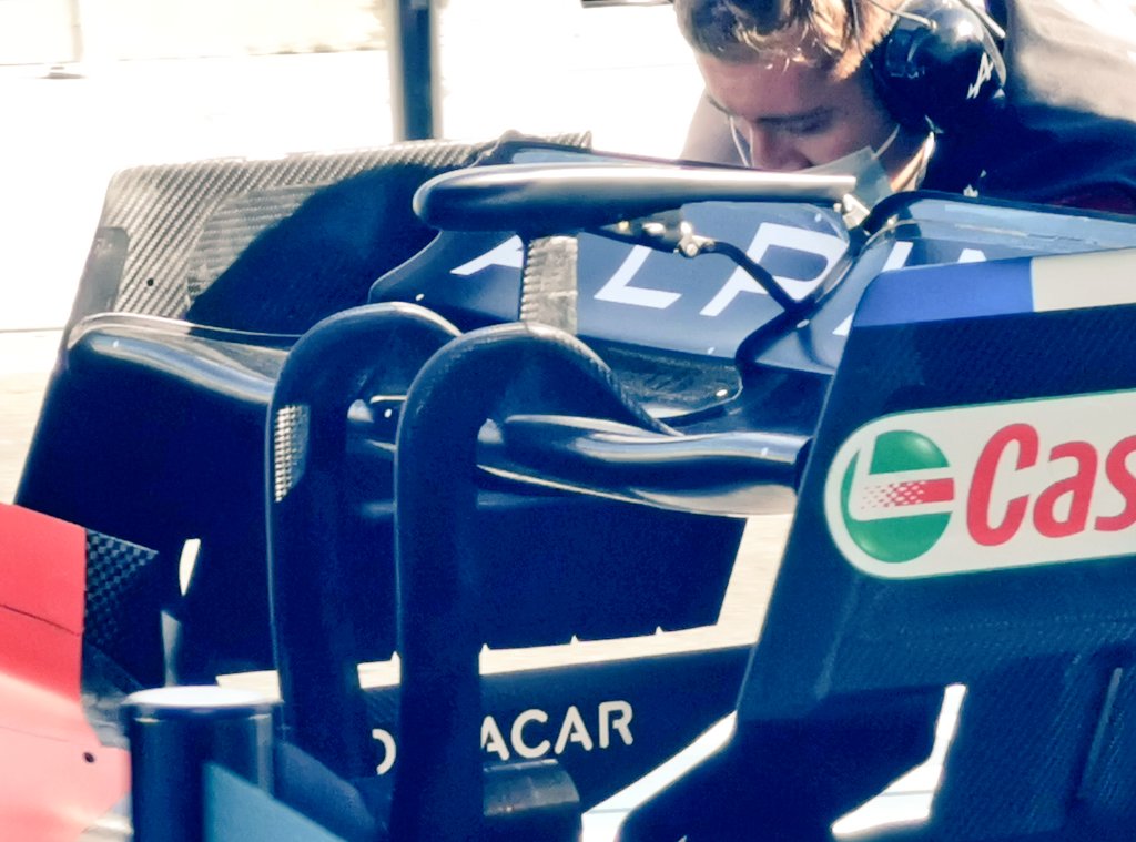

I was thinking about the stickers again earlier today, and I now think it might be far easier to use them to monitor wing deflection/rotation that some of us thought previously.
Since the stickers are circles they will have the same width and height when they are parallel to the camera. When they are at an angle to the camera, the width will stay the same, while the height (as perceived in a frame grab) will be less. I think the change in height is just a cosinusoidal relationship to the angle. When Parallel to the camera the angle is zero and the height and width are the same. Perpendicular to the camera and the height goes to zero, ie the cosine of 90 degrees.
If the camera is of sufficient resolution and sharpness, then you don't need to have a whole bunch of known distances to do calculations. All the information you need is contained within a frame.
Edit: you might even be able to use a similar methodology with 2 dots, if they are known distance apart, thus making camera resolution less significant.
Agreed, although I probably wouldn’t have used “round” stickers and instead, checkered ones since it would have assist on accurate measurements.

You guys mean sth like this?
