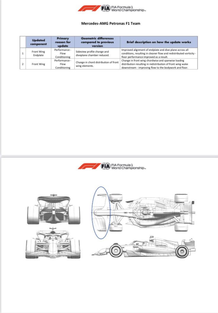

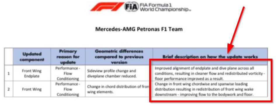

1. So this new front wing is aiming to increase the low-speed corner grip coz I don`t see how it would improve the rear-end grip?
2. Seems that in FP1 HAM tested the old FW and RUS the new one sporting lots of understeer on both cars ... setup issues or do they need to protect the rear tyres as they are aiming for a one-stop M-H race on Sunday?

A front wing can control tire wake. This can have considerable downstream effects.
This was a key development area in the previous regulations.
