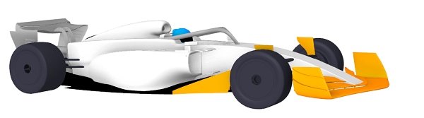

Re: [MVRC] Mantium Virtual Racecar Challenge 2022 (Grand Prix Cars)
Here's the updated car for Monza. Changes are:
- smaller rear wing, less aggressive beam wings, tighter rear end, maxed out gills array, larger sidepods slats, open front wing endplates.
As the previous one, this is also largely FIA legal.
G-raph wrote:
11 Sep 2022, 23:26
The full story is this one :
I'll confirm that it's very impressive, then.
It sounds like you have experience in F1 too. You guys should found a club...
Another sinuous car from PurePower!
And if yinlad's updates on the front work, he'll also be fighting for the podium.

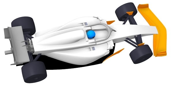

yinlad wrote:
12 Sep 2022, 12:44
Some prettier renders, albeit with the lower poly count STLs
Another interesting car.
I'm starting to think the MVRC level is too high for me (with only a mechanical back ground) this year
Anyway, this are additional images of the car for Monza.
As Variante is doing, I am trying to keep the car as much near to FIA rules as possible, except for some details that are impossibile (or penalising) to replicate because of the 10mm rule.
